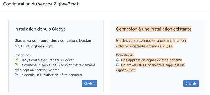

In your case, I think it would be good to manage z2m that way.
However, you’ll need to disable z2m management by Gladys, then set up Portainer, start a Stack (with z2m version 2.3.0 for example) and run it. Then go back into Gladys and add your external z2m docker:
Hope you get everything back.
