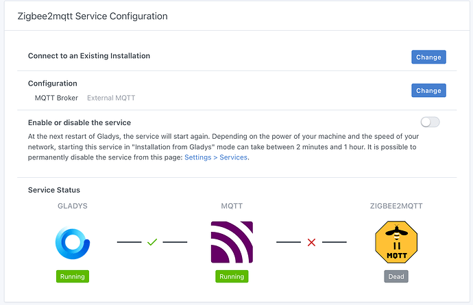

However, between her house, mine, the office, two datacenters, my car over LTE (yes yes I’m nuts), I have several brokers bridged together, which host 4 different Z2M on… 4 different topics none of which is ‹ zigbee2mqtt/# › which is hardcoded in server/services/zigbee2mqtt/lib/constants.js, rather ‹ z2mtln/# › ‹ z2mdc2/# › ‹ z2msixf/# › ‹ z2mdijon/# › etc… that lets me, without breaking my head, gather stats in one place
And bam, it doesn’t work at all.
