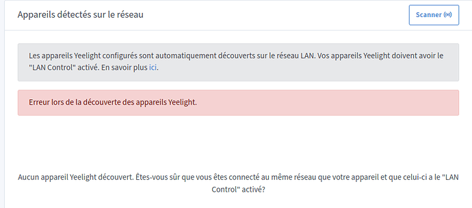

Voila ce que je peux te donner comme logs avec des erreurs après avoir effectué le scan
2022-12-19T21:50:56+0100 <error> index.js:15 (process.<anonymous>) unhandledRejection catched: Promise {
  <rejected> Error: Not running
      at new NodeError (node:internal/errors:393:5)
      at healthCheck (node:dgram:908:11)
      at Socket.close (node:dgram:740:3)
      at /src/server/services/yeelight/node_modules/yeelight-awesome/src/discover.ts:177:29
      at new Promise (<anonymous>)
      at Discover.destroy (/src/server/services/yeelight/node_modules/yeelight-awesome/src/discover.ts:174:16)
      at Timeout._onTimeout (/src/server/services/yeelight/lib/device/discover.js:28:22)
      at listOnTimeout (node:internal/timers:564:17)
      at processTimers (node:internal/timers:507:7) {
    code: 'ERR_SOCKET_DGRAM_NOT_RUNNING'
2022-12-19T21:50:56+0100 <error> index.js:16 (process.<anonymous>) Error: Not running
My LED strip is found immediately.
I can add it to a dashboard
I can control the strip from the dashboard but still get no feedback if I control it from my Yeelight app or Node-RED.
The various errors when using it
2022-12-19T21:58:31+0100 <error> device.poll.js:24 (DeviceManager.poll) NotFoundError: YEELIGHT_DEVICE_NOT_FOUND
    at YeelightHandler.poll (/src/server/services/yeelight/lib/device/poll.js:60:11)
2022-12-19T22:00:01+0100 <error> device.poll.js:23 (DeviceManager.poll) There was an error while polling device yeelight-0x00000000156f48b5
This is the only strip I own and there are no other logs concerning this service.

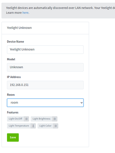

I pushed a new image with a fix for model detection.
Image available for testing: docker pull nickdub/gladys:dev
I’ll try to do a test over the weekend
Good news — today I do see a model name displayed for my LED strip! :smiley:
However I can still control my LED strip from Gladys, but as before I don’t get any status feedback when I control the LED strip from another application, and I still get the error in the logs at every refresh.
OK, so the fix for the detection works :+1:
What’s left is the state feedback…

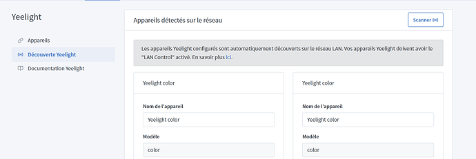

@_Will_71 Everything’s OK on my end, can you check (I pushed an image back)?
Ok I’ll try tonight or tomorrow evening. I’ll let you know.
@Pti_Nico, I’m sorry but tonight it’s impossible to find my device while the other attempts were fine!
And I don’t have any errors in the logs
Strange, with my setup, no problems… :thinking:
And the response works:
I can add more logs… ???
I added logs and restarted the image creation…
Ok I’ll do another test
Sorry, no luck. It can’t find my LED strip and I have no logs.
What’s the exact model number of your LED strip?
Because only Yeelight devices (not Xiaomi) are detected (provided LAN mode is enabled…)
PS: I’m saying this because my Mi 1S LED desk lamp is detected in the Yeelight app but not in Gladys.
What’s strange is that the strip was correctly recognized in January.
The exact model is Yeelight Strip 6.
Also, if you can’t add it for now, no problem for me because I manage it with Node-RED.
I don’t want my banner to hold up the progress of your integration.
I’m not adding anything, it’s detected automatically…
That’s why I don’t understand :thinking:
