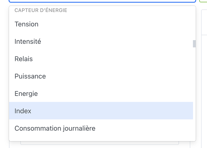

The « Teleinformation (Téléinformation) » device is really specific to the Lixee TIC normally, and normally it’s the Zigbee2mqtt integration that creates these features with the correct units :stuck_out_tongue:
In your case, in my opinion if the only thing that interests you is monitoring your electricity consumption, you should use the « Energy sensor / index » feature:
For these features:
image (1)
If the value is not an index (if it’s just a kWh value that resets at each reading), you can use the « Energy sensor / Energy » feature.
