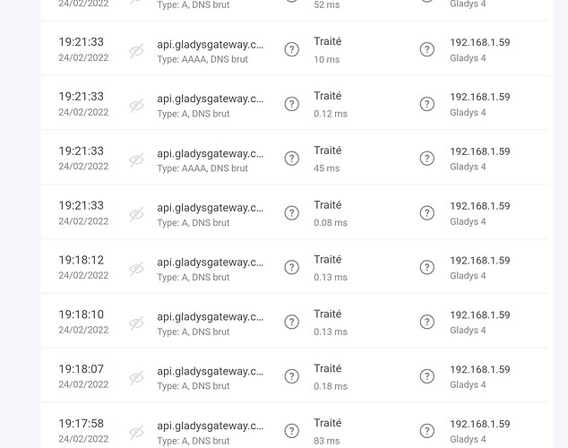

Côté DNS, pas de requête bloquée pourtant
This kind of error is rather clear, it’s a DNS issue.
What is interesting is that we notice something: there are dozens of DNS resolution requests in a row, without any respect for the TTL I give, as there are sometimes 2 requests in the same second!
I conclude that Gladys keeps asking for the server address of the Gateway with each request. Not crazy!

Is the DNS issue I’m experiencing coming from the ano on the node image or from AdGuard blocking at a certain time?
Thanks for your response
Hard to say, it could come from several points:
Locally, the local DNS resolver service that trips over its own feet because there are too many requests in a short time
Adguard having trouble responding to the load, as we can see, adguard is contacted for each request

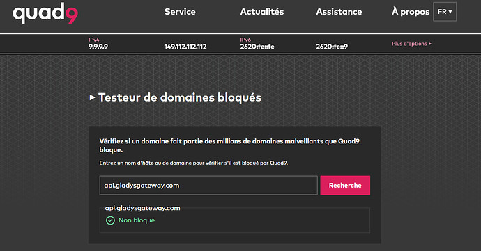

I did the manipulation as I mentioned here:
Hello, désolé d’avoir pris du temps pour te répondre.
=> j’ai tjrs des soucis de DNS j’ai pas encore pris le temps de passer sur quad9 (pour le test), je viens de le faire et j’ai encore le soucis côté G+.
=> Yes j’ai bien systématiquement le soucis sur G+ en local tout est ok donc rien d’urgent
c’est un peu compliqué, mais peut être vendredi si je n’ai pas de changement en cours de route ^^’
And I did check that I was going through quad9:
Just have to see if I encounter the same issues in the medium term

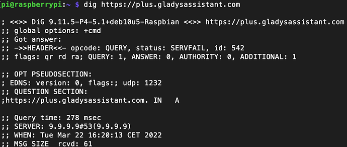

I just checked your ‹ dig ›
You don’t have a dns response
On the Quad9 side the domain is ok

Really weird your problem (I’m in a similar conf Quad9/Pihole)
Testing your route
pi@raspberrypi:~ $ dig api.gladysgateway.com
<<>> DiG 9.11.5-P4-5.1+deb10u5-Raspbian <<>> api.gladysgateway.com
;; global options: +cmd
;; Got answer:
;; ->>HEADER<<- opcode: QUERY, status: NOERROR, id: 55078
;; flags: qr rd ra; QUERY: 1, ANSWER: 1, AUTHORITY: 0, ADDITIONAL: 1
;; OPT PSEUDOSECTION:
; EDNS: version: 0, flags:; udp: 1232
;; QUESTION SECTION:
;api.gladysgateway.com. IN A
;; ANSWER SECTION:
api.gladysgateway.com. 119 IN A 142.93.160.146
;; Query time: 50 msec
;; SERVER: 9.9.9.9#53(9.9.9.9)
;; WHEN: Wed Mar 23 14:04:12 CET 2022
;; MSG SIZE rcvd: 66
No issues either ^^
