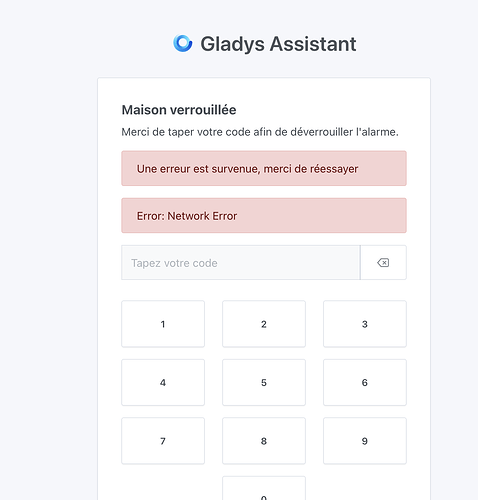

I added the error message in case the error is unknown.
For example, if the network is down it will look like this:

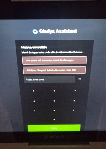

Hi @Philou @spenceur :slight_smile: Have you had the error since the last update?
If so, I’d like the error message that must have appeared above the numeric keypad
Nothing from me yet :slight_smile:
No error message, but the absence of a message may be related to my database-locked problems at times. To be confirmed over time — I haven’t had any disconnections for 3 days.
