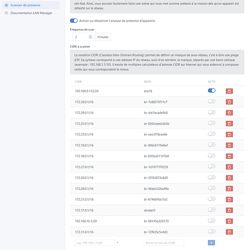

Can you send a screenshot of your settings page?
Of course
Ok, that looks good.. I’m not a networking expert though :grinning_face_with_smiling_eyes:
