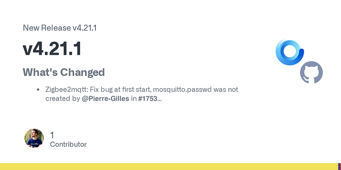

The fix is available in Gladys Assistant v4.21.1:
