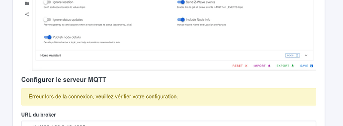

@pierre-gilles, I had another disconnection of zwavejs from the MQTT broker. My wife wasn’t happy because the garage door wouldn’t open anymore!
So there was nothing abnormal in the logs — except that the scene wasn’t working because of the MQTT broker disconnection.
2025-02-15T18:24:49+0100 <warn> scene.executeActions.js:37 (executeAction) ServiceNotConfiguredError: MQTT is not configured.
    at ZwaveJSUIHandler.publish (/src/server/services/zwavejs-ui/lib/zwaveJSUI.publish.js:12:11)
    at ZwaveJSUIHandler.setValue (/src/server/services/zwavejs-ui/lib/zwaveJSUI.setValue.js:97:10)
    at DeviceManager.setValue (/src/server/lib/device/device.setValue.js:21:24)
    at Object.device.set-value (/src/server/lib/scene/scene.actions.js:66:24)
    at executeAction (/src/server/lib/scene/scene.executeActions.js:32:35)
    at /src/server/lib/scene/scene.executeActions.js:66:13
    at tryCatcher (/src/server/node_modules/bluebird/js/release/util.js:16:23)
    at MappingPromiseArray._promiseFulfilled (/src/server/node_modules/bluebird/js/release/map.js:68:38)
    at MappingPromiseArray.PromiseArray._iterate (/src/server/node_modules/bluebird/js/release/promise_array.js:115:31)
    at MappingPromiseArray.init (/src/server/node_modules/bluebird/js/release/promise_array.js:79:10)
    at MappingPromiseArray._asyncInit (/src/server/node_modules/bluebird/js/release/map.js:37:10)
    at _drainQueueStep (/src/server/node_modules/bluebird/js/release/async.js:97:12)
    at _drainQueue (/src/server/node_modules/bluebird/js/release/async.js:86:9)
    at Async._drainQueues (/src/server/node_modules/bluebird/js/release/async.js:102:5)
    at Immediate.Async.drainQueues (/src/server/node_modules/bluebird/js/release/async.js:15:14)
    at processImmediate (node:internal/timers:476:21)

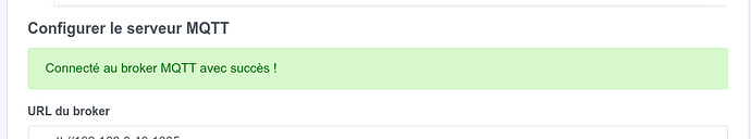

After saving the config everything was OK.
I checked my mqtt container and it had been updated 16 hours earlier.
So, I tried stopping the container manually and the issue occurred. So if Gladys loses the connection because the container is stopped or updated… Gladys does not reconnect automatically.
I hadn’t noticed that I had used the latest version. I’ll block it to prevent any automatic updates on this container.
