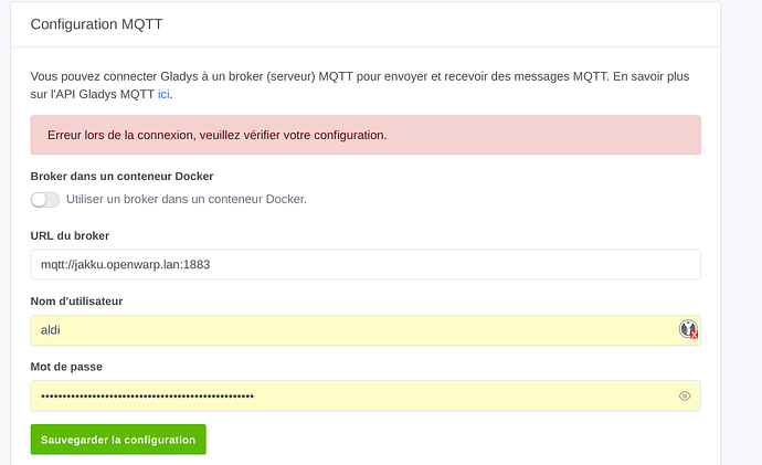

Hi @bong101,
As mentioned above, I have exactly this setup, my mosquitto broker is 12.5.0.100, my Gladys and most of my devices are on 12.5.0.xxx and some devices on 12.1.0.xxx and I have no issues by specifying the broker address in Gladys mqtt://12.5.0.100:1883.
As suggested above, are you sure your browser is not auto-filling the fields? (Really to rule out that possibility)
Because usually fields that appear in yellow like in your photo are autocompleted:
And from other conversations on the forum, some browsers would replace the password when clicking Save, from what I understood.

I have the same problem with Gladys installed in Docker on a Proxmox VM. I’m testing Gladys.
I’m trying to connect to the Mosquitto Broker of my Home Assistant. The connection works fine via MQTT Explorer.
I’m attaching a GIF; the toggle automatically switches to a Docker container.
gladys mqttbroquer
Thank you in advance
Gladys version 4.38
PS: If you prefer that I open another thread, I can do so.

Does the toggle switch back by itself when saving the settings, like it does for me?
yes!!! as if we didn’t have a choice
