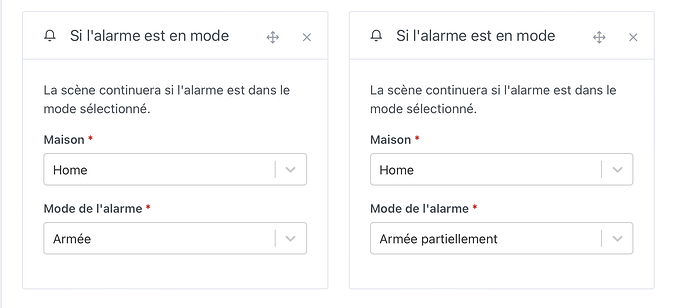

I have an initial feedback regarding the conditions « if the alarm is in mode »
Currently I have a scene: if my wife comes home, I disable the alarm.
Until now I only managed a total alarm.
Is it possible to improve this condition with a multiple select and thus choose the two modes with « or » ?
because as it stands, if I make these two conditions, they will both have to be true to proceed to the next action.
If you put the boxes side by side, it’s an ‹ or ›
Arf, I got fooled too! oops Thanks
No, it’s an AND!
If you want to do the case you describe @spenceur, currently you have to make 2 different scenes

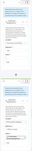

For the ‹ and ›, shouldn’t they be placed one after the other?
Doesn’t that correspond to the ‹ continue only if › block?

I find @spenceur’s request relevant; maybe we could add to the block Si l'alarme est en mode the small +or button that already exists in the block continuer si et seulement si:
No!
Each action block is a set of actions that are executed in parallel. When all actions have completed successfully, we move on to the next action block.
Except that if an action returns a scene interruption, the scene stops.
So if you put 2 actions « If the alarm is in armed mode » / « If the alarm is in partially armed mode », whether in series or in parallel, one of the two actions will necessarily stop. The condition will always be false :slight_smile:
Why not! Feature request? :slight_smile:
So that’s useless:
For me, « in parallel » meant that if one was true, you kept going…
If a skier falls in a parallel slalom, the other keeps going, right?
I’ve only been wrong for three years… :innocent:
Done => Pouvoir ajouter plusieurs mode dans la condition si alarme en mode
