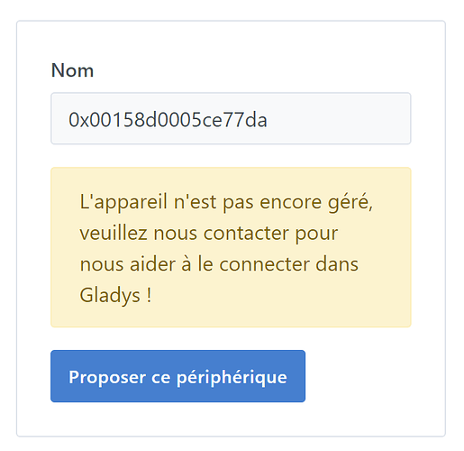

Following the latest Gladys release, I invested in the Lixee TIC module.
However, it does not seem to be supported

So I started again from a fresh install and the lixee is properly recognized
