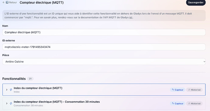

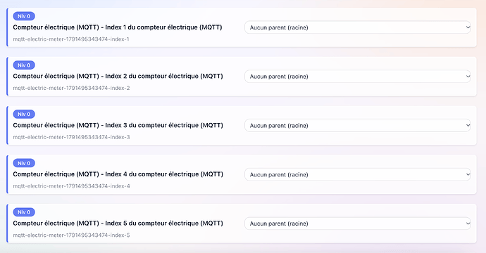

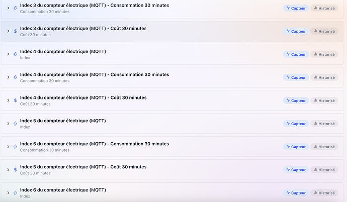

  • Creation of a virtual MQTT energy meter
  • Creation of the 6 TEMPO indexes (Index, 30-minute Consumption, 30-minute Cost) and the Base index always Null but the info is sent by Lixee
  • Import of Tempo rates on the virtual MQTT energy meter
  • Recalculation of consumption and then costs

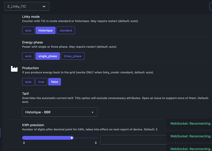

- Linky meter in historical mode, EDF Tempo contract (BBR)
- Lixee ZLinky TIC via Zigbee2mqtt, 7 features Index (Base + 6 Tempo indexes), each with its "30-minute Consumption" and "30-minute Cost" features

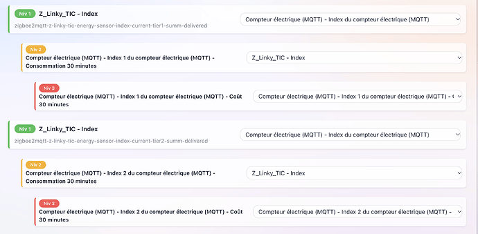

- Tempo rates imported via Energy Monitoring > Energy Rates > Import, with "Create an electric meter" (MQTT meter)

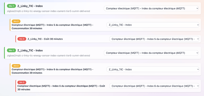

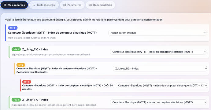

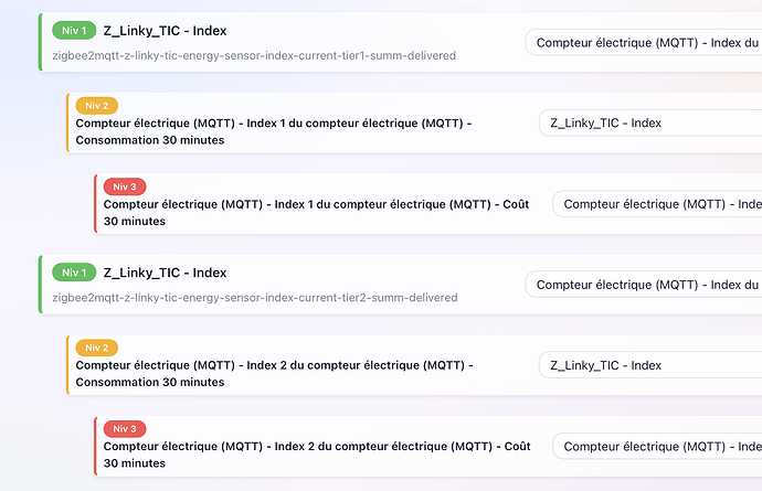

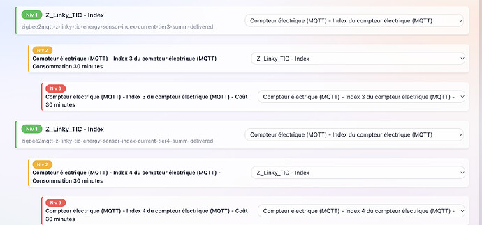

- The ZLinky indexes are attached to the electric meter in the hierarchy (Level 0: meter, Level 1: Index, Level 2: 30-minute Consumption, Level 3: 30-minute Cost)

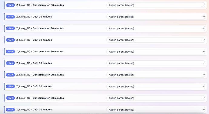

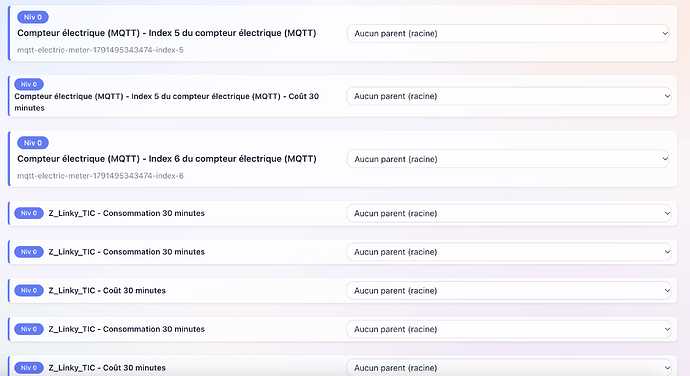

## Problem
After modifying the hierarchy, the 30-minute consumption calculation no longer finds any INDEX / 30-minute consumption pairs. No consumption or cost is calculated. The two recalculation buttons in the Settings tab also fail.

2026-10-08T22:30:00+0000 energy-monitoring.calculateEnergyFromIndex.js:68 (EnergyMonitoringHandler.calculateEnergyFromIndex) Found 0 INDEX/thirty-minutes-consumption feature pairs
2026-10-08T22:30:00+0000 energy-monitoring.calculateEnergyFromIndex.js:166 (EnergyMonitoringHandler.calculateEnergyFromIndex) Finished calculating consumption from index for 0 devices

2026-10-08T23:00:53+0000 energy-monitoring.calculateEnergyFromIndexFromBeginning.js:27 () Calculating consumption from index from beginning in timezone Europe/Paris
2026-10-08T23:00:53+0000 energy-monitoring.calculateEnergyFromIndexFromBeginning.js:34 () Found 5 energy devices
2026-10-08T23:00:53+0000 energy-monitoring.calculateEnergyFromIndexFromBeginning.js:76 () Found 0 devices with both INDEX and thirty-minutes-consumption features
2026-10-08T23:00:53+0000 energy-monitoring.calculateEnergyFromIndexFromBeginning.js:81 () No devices found with both features, nothing to process
2026-10-08T23:07:34+0000 energy-monitoring.calculateEnergyFromIndexFromBeginning.js:27 () Calculating consumption from index from beginning in timezone Europe/Paris
2026-10-08T23:07:34+0000 energy-monitoring.calculateEnergyFromIndexFromBeginning.js:34 () Found 5 energy devices
2026-10-08T23:07:34+0000 energy-monitoring.calculateEnergyFromIndexFromBeginning.js:76 () Found 0 devices with both INDEX and thirty-minutes-consumption features
2026-10-08T23:07:34+0000 energy-monitoring.calculateEnergyFromIndexFromBeginning.js:81 () No devices found with both features, nothing to process

## Questions
1. Why doesn't Gladys find the INDEX / 30-minute consumption pairs anymore even though the hierarchy is correct on screen?
2. Is there a condition on the hierarchy (for example an index attached to an MQTT meter created by the import of the rates) that would exclude these pairs from the calculation?
3. What procedure do you recommend to properly rebuild the hierarchy?
Thank you for your help
Requesting help to configure a Tempo contract in energy monitoring, nothing works, I don’t know where the problem comes from. Whether it’s a bug in Gladys or an incorrect configuration.
Do I need to create the MQTT meter or directly select the TIC lixee which is connected via Zigbee? The manual says to create an electricity meter but the tariff calculation is not done
Here’s what I configured in the virtual meter 6 indexes corresponding to the 6 Tempo tariffs
Tariff for the BBRHCJB off-peak blue day index, the structure is the same for the other 5 tariffs
