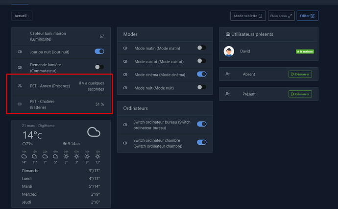

## **Step 4: Check in the dashboard**
Add the widgets to your Gladys dashboard:
* A widget with the cat’s “Presence” feature — will display 1 (inside) or 0 (outside)
* A “Gauge” widget for the cat flap battery
The bridge polls every 60 seconds. When your cat passes through the cat flap, the value changes at the next poll cycle.

So, doing a hybrid Matterbridge + MQTT to compensate for the gaps was a lot of tinkering for not much. The pure MQTT bridge covers 100% of the need from day one, without waiting for features to be added on the Gladys or Matter side.
And let’s be honest: for cloud polling every 60 seconds on a cat flap, Matter brings no advantage. Matter is designed for real-time local control — this is just sensor data reporting from a third-party cloud.
## **Limitations**
* **Cloud only**: no local control, dependency on Sure Petcare servers
* **Latency**: between 0 and 60 seconds depending on the poll time (configurable via `POLL_INTERVAL`)
* **Read-only**: the bridge does not yet handle locking/unlocking the cat flap from Gladys. It is technically possible with surepy, if it interests people I can add the feature
* **No last passage**: Gladys does not have a native “timestamp” feature. However, the presence feature in Gladys records when the value changed — this is effectively your “last passage”
## **Technical stack**
* **Python 3.12** (Docker slim)
* **surepy** v0.9.0 — Python library for the Sure Petcare API (the same as Home Assistant)
* **paho-mqtt** v2.x — MQTT client
* **~50 MB RAM** in operation
Successfully tested on a Synology DS1520+ NAS with Gladys v4, Mosquitto, and a Cat Flap Connect + Sure Petcare Hub.
If you have any questions or suggestions for improvement, feel free to ask!
