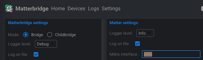

For mdns, you need to retrieve the name of your interface (visible on the matterbridge dashboard) and put it in the network Settings:

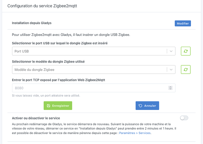

For the zigbee2mqtt plugin part, you must have activated the zigbee2mqtt integration in Gladys, chosen a USB key and its port.
If this is not your setup, you will need to provide screenshots of your configuration.

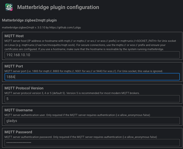

You will also need the username and password for the zigbee2mqtt integration, as well as the IP and port to zigbee2mqtt (sorry, I don’t have a screenshot).
I assume that the IP address of your Gladys is 192.168.10.10, you will change it with your values.
Moreover, the integration has created an mqtt server that you do not see but is indeed present (on port 1884) and this is what we are going to configure in matterbridge.
Here is the configuration to put in matterbridge:

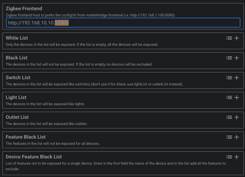

The port
12000 in my screenshot will need to be modified according to what you have in Gladys.

Thank you very much for the reply. The Mdns is indeed fixed by setting the interface name.
For zigbee2mqtt, I have indeed successfully enabled the integration via the USB port and a Sonoff key.
For the settings, I just need the password and I don’t know where to find it.
Can you enlighten me?
Oops, I thought it was in the zigbee2mqtt integration config page
So it’s probably in a configuration file, but I don’t know which one (I have an external zigbee2mqtt and an external MQTT server, so different config).
@pierre-gilles could you guide @deckard24 to retrieve the password? Thanks!
Small question, why do you need to do that?
If you launch Zigbee2mqtt automatically via Gladys, and you had a standard Gladys installation with the official docker run/compose available on the site, then it is available with this command:
cat /var/lib/gladysassistant/zigbee2mqtt/z2m/configuration.yaml
You will see a « mqtt » section at the top of the file with the information
