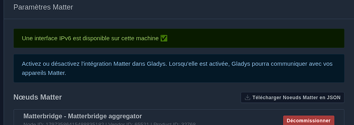

You can still keep your IKEA gateway — I looked around a bit online and I think it should be able to expose the pilot wire (fil pilote) information.
Could you share the JSON from the Matter settings with us?
This will allow us to check what’s exposed and possibly let a dev add the pilot wire support if needed.
This gateway already bridges Thread, Wi-Fi and Matter, so it can be very useful to keep it for pairing your Matter devices.
I had shared it here: Intégrer la passerelle IKEA Dirigera Matter dans Gladys - #9 par 4get9
In the JSON, there is no device exposed as Pierre-Gilles had explained.
Could you retake screenshots now that you have paired and managed to share with Gladys and download the JSON, please?

Here is the config file:

Thank you for your JSON. I’ll look at it as soon as I can.
In the JSON, your module is exposed as onoffpluginunit, therefore only as an ON/OFF switch.
We can’t find the pilot wire information exposed by your IKEA gateway.
