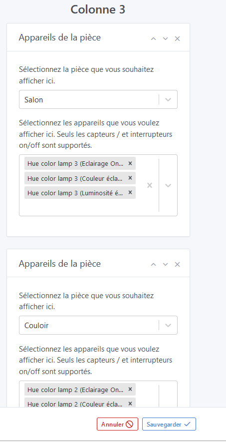

Thanks to the great tutorials available, I connected my Philips Hue bridge and registered the different lamps in each room. I can control them via the dashboard without any problem. I also integrated Telegram and tested it with the OpenWeather integration, perfect. However, when I ask for a command like « Turn on living room », it tells me it didn’t find any light in that room. Same for all other rooms. Did I miss something? Or do I need to create scenes to be able to control the lights via Telegram?

Have you properly set up your lights in the hue integration? Can you provide screenshots of this part and your dashboard
I may have missed something, below are screenshots of the integration of the lamps/parts and the dashboard.
Can you try with these sentences?
Turn on the light in the Living Room
Turn on in the Living Room
