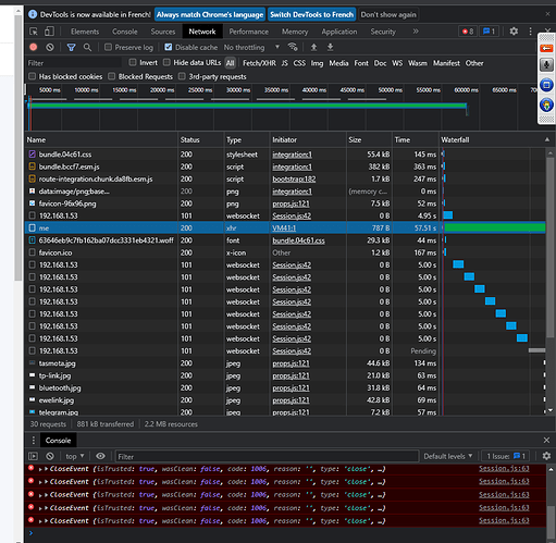

The Gladys web interface regularly takes a very long time to load at my place, without any apparent reason.
  • htop normal, few resources used
  • iotop same (htop equivalent at disk level, I am on SD card in read-only mode for the system to preserve it)
  • docker stats normal, everything is around 0% to 10%
  • network: the Zigbee2MQtt web service loads in less than 1 second (on the Rpi as well)
  • Gladys Log, nothing to report.
At the browser level (Chrome), you can see one of the requests taking 57 seconds and others taking 5 seconds!
I only loaded the homepage of my instance.

57 seconds on a get myself, that’s clearly not normal! This request should take less than 100ms.
Is the aggregation not currently running on your instance? Or the Gladys Plus backup?
There must be something blocking
I thought the same thing, but I can’t figure out what it could be. And since I notice this regularly, I don’t think it’s the backup or aggregation that take just a few minutes.

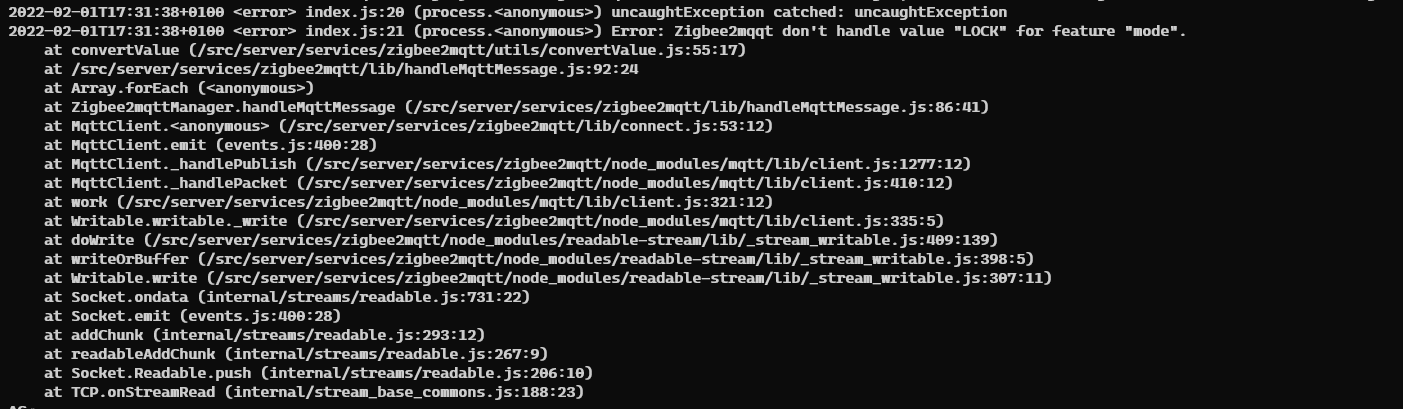

I found an error in the Zigbee2MQTT service. It seems an unhandled value caused the service to crash (error).
@cicoub13 would you have any idea what to look for?
You know on which device?
Not at all. Same error on restart.

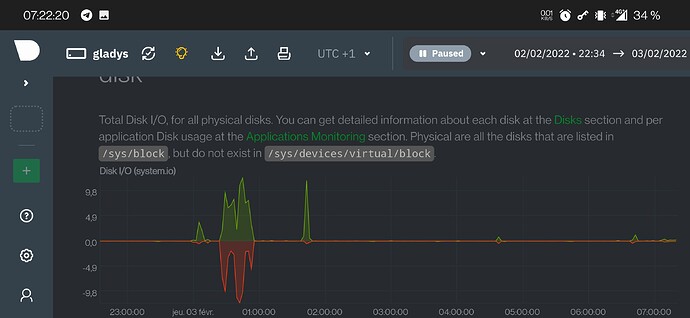

Disk Write Limitation
I’m surprised, as this is not a problem that happens several times a day, which I temporarily solve by simply restarting.
Since this morning, the disk has been very lightly used with an average of 50 KB/sec, far from the 10 MB of this morning during the problem. There have even been aggregations since, without any particular issues.
Additionally, I turned off the CO2 sensor that seemed to be causing a lot of pollution.
In my opinion, the theory of the disk being saturated with writes is not the right explanation for all of this.

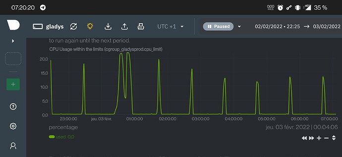

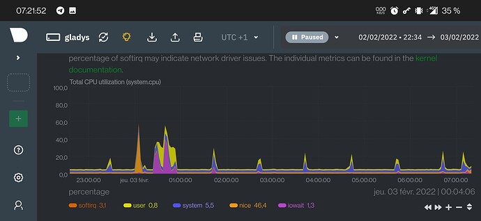

CPU, RAM, Disk Resources
Everything is normal according to Netdata. The peak at 00:00 corresponds to my Restic backup to backblaze.

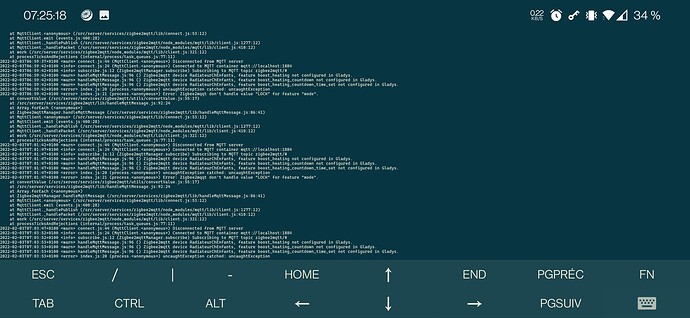

My initial hypothesis might be confirmed @pierre-gilles and @cicoub13. It seems the « unhandled » error is crashing the zigbee2mqtt service, unlike usual, this is not a warning log but a nodejs crash.
  • Gladys startup: 07:07:44
  • First error: 07:36:35
    Since then, nothing works again.
First error logs
2022-02-03T07:36:35+0100 <warn> handleMqttMessage.js:96 () Zigbee2mqtt device RadiateurSalleaManger, feature boost_heating not configured in Gladys.
2022-02-03T07:36:35+0100 <warn> handleMqttMessage.js:96 () Zigbee2mqtt device RadiateurSalleaManger, feature boost_heating_countdown not configured in Gladys.
2022-02-03T07:36:35+0100 <warn> handleMqttMessage.js:96 () Zigbee2mqtt device RadiateurSalleaManger, feature boost_heating_countdown_time_set not configured in Gladys.
2022-02-03T07:36:35+0100 <error> index.js:20 (process.<anonymous>) uncaughtException catched: uncaughtException
2022-02-03T07:36:35+0100 <error> index.js:21 (process.<anonymous>) Error: Zigbee2mqqt don't handle value "LOCK" for feature "mode".
    at convertValue (/src/server/services/zigbee2mqtt/utils/convertValue.js:55:17)
    at /src/server/services/zigbee2mqtt/lib/handleMqttMessage.js:92:24
    at Zigbee2mqttManager.handleMqttMessage (/src/server/services/zigbee2mqtt/lib/handleMqttMessage.js:86:41)
    at MqttClient.<anonymous> (/src/server/services/zigbee2mqtt/lib/connect.js:53:12)
    at MqttClient.emit (events.js:400:28)
    at MqttClient._handlePublish (/src/server/services/zigbee2mqtt/node_modules/mqtt/lib/client.js:1277:12)
    at MqttClient._handlePacket (/src/server/services/zigbee2mqtt/node_modules/mqtt/lib/client.js:410:12)
    at work (/src/server/services/zigbee2mqtt/node_modules/mqtt/lib/client.js:321:12)
    at Writable.writable._write (/src/server/services/zigbee2mqtt/node_modules/mqtt/lib/client.js:335:5)
    at doWrite (/src/server/services/zigbee2mqtt/node_modules/readable-stream/lib/_stream_writable.js:409:139)
    at writeOrBuffer (/src/server/services/zigbee2mqtt/node_modules/readable-stream/lib/_stream_writable.js:398:5)
    at Writable.write (/src/server/services/zigbee2mqtt/node_modules/readable-stream/lib/_stream_writable.js:307:11)
    at Socket.ondata (internal/streams/readable.js:731:22)
    at Socket.emit (events.js:400:28)
    at addChunk (internal/streams/readable.js:293:12)
    at readableAddChunk (internal/streams/readable.js:267:9)
    at Socket.Readable.push (internal/streams/readable.js:206:10)
    at TCP.onStreamRead (internal/stream_base_commons.js:188:23)
2022-02-03T07:37:48+0100 <info> calendar.requests.js:52 () CalDAV : Found calendar [redacted]@gmail.com
2022-02-03T07:37:48+0100 <info> calendar.requests.js:52 () CalDAV : Found calendar Contacts
2022-02-03T07:37:48+0100 <info> calendar.requests.js:52 () CalDAV : Found calendar PERSO
2022-02-03T07:37:48+0100 <info> calendar.requests.js:52 () CalDAV : Found calendar Public holidays in France
2022-02-03T07:37:48+0100 <info> calendar.syncUserCalendars.js:38 (CalDAVHandler.syncUserCalendars) CalDAV : Found 5 calendars.
2022-02-03T07:38:11+0100 <warn> connect.js:44 (MqttClient.<anonymous>) Disconnected from MQTT server
2022-02-03T07:38:16+0100 <info> connect.js:24 (MqttClient.<anonymous>) Connected to MQTT container mqtt://localhost:1884
2022-02-03T07:38:16+0100 <info> subscribe.js:12 (Zigbee2mqttManager.subscribe) Subscribing to MQTT topic zigbee2mqtt/#
2022-02-03T07:38:16+0100 <warn> handleMqttMessage.js:96 () Zigbee2mqtt device RadiateurChEnfants, feature boost_heating not configured in Gladys.
2022-02-03T07:38:16+0100 <warn> handleMqttMessage.js:96 () Zigbee2mqtt device RadiateurChEnfants, feature boost_heating_countdown not configured in Gladys.
2022-02-03T07:38:16+0100 <warn> handleMqttMessage.js:96 () Zigbee2mqtt device RadiateurChEnfants, feature boost_heating_countdown_time_set not configured in Gladys.
2022-02-03T07:38:16+0100 <error> index.js:20 (process.<anonymous>) uncaughtException catched: uncaughtException
2022-02-03T07:38:16+0100 <error> index.js:21 (process.<anonymous>) Error: Zigbee2mqqt don't handle value "LOCK" for feature "mode".
    at processTicksAndRejections (internal/process/task_queues.js:77:11)
2022-02-03T07:40:16+0100 <warn> connect.js:44 (MqttClient.<anonymous>) Disconnected from MQTT server
2022-02-03T07:40:21+0100 <info> connect.js:24 (MqttClient.<anonymous>) Connected to MQTT container mqtt://localhost:1884
2022-02-03T07:40:21+0100 <info> subscribe.js:12 (Zigbee2mqttManager.subscribe) Subscribing to MQTT topic zigbee2mqtt/#

2022-02-03T07:36:35+0100 index.js:20 (process.) uncaughtException catched: uncaughtException
2022-02-03T07:36:35+0100 index.js:21 (process.) Error: Zigbee2mqqt don’t handle value « LOCK » for feature « mode ».
at Array.forEach ()
at MqttClient. (/src/server/services/zigbee2mqtt/lib/connect.js:53:12)
2022-02-03T07:42:21+0100 connect.js:44 (MqttClient.) Disconnected from MQTT server
2022-02-03T07:42:26+0100 connect.js:24 (MqttClient.) Connected to MQTT container mqtt://localhost:1884
2022-02-03T07:42:26+0100 subscribe.js:12 (Zigbee2mqttManager.subscribe) Subscribing to MQTT topic zigbee2mqtt/#
2022-02-03T07:42:26+0100 handleMqttMessage.js:96 () Zigbee2mqtt device RadiateurChEnfants, feature boost_heating not configured in Gladys.
2022-02-03T07:42:26+0100 handleMqttMessage.js:96 () Zigbee2mqtt device RadiateurChEnfants, feature boost_heating_countdown not configured in Gladys.
2022-02-03T07:42:26+0100 handleMqttMessage.js:96 () Zigbee2mqtt device RadiateurChEnfants, feature boost_heating_countdown_time_set not configured in Gladys.
2022-02-03T07:42:26+0100 index.js:20 (process.) uncaughtException catched: uncaughtException
2022-02-03T07:42:26+0100 index.js:21 (process.) Error: Zigbee2mqqt doesn’t handle value « LOCK » for feature « mode ».
at Array.forEach ()
2022-02-03T07:44:26+0100 connect.js:44 (MqttClient.) Disconnected from MQTT server
2022-02-03T07:44:31+0100 connect.js:24 (MqttClient.) Connected to MQTT container mqtt://localhost:1884
2022-02-03T07:44:31+0100 subscribe.js:12 (Zigbee2mqttManager.subscribe) Subscribing to MQTT topic zigbee2mqtt/#
2022-02-03T07:44:31+0100 handleMqttMessage.js:96 () Zigbee2mqtt device RadiateurChEnfants, feature boost_heating not configured in Gladys.
2022-02-03T07:44:31+0100 handleMqttMessage.js:96 () Zigbee2mqtt device RadiateurChEnfants, feature boost_heating_countdown not configured in Gladys.
2022-02-03T07:44:31+0100 handleMqttMessage.js:96 () Zigbee2mqtt device RadiateurChEnfants, feature boost_heating_countdown_time_set not configured in Gladys.
2022-02-03T07:44:31+0100 index.js:20 (process.) uncaughtException catched: uncaughtException
2022-02-03T07:44:31+0100 index.js:21 (process.) Error: Zigbee2mqqt doesn’t handle value « LOCK » for feature « mode ».
at Array.forEach ()
2022-02-03T07:46:31+0100 connect.js:44 (MqttClient.) Disconnected from MQTT server
I will propose a fix this afternoon.
