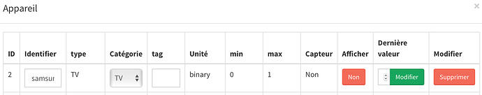

Thanks to the Network Scanner module, Gladys found my TV.
I was able to add my TV as a device:

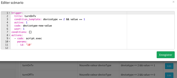

I then created two scenarios when the value of my device changes:

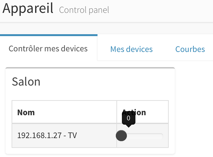

However, when I change the value of my device via the button
I end up with these errors that I must admit, I do not understand:

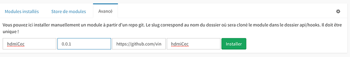

When you cloned your module in Gladys, did you go through the « Advanced » view, right?
And if so, what did you put in the « Slug » field?
I entered these values:
However, I just noticed that my module disappeared after a Gladys reboot ^^'.

And after the reboot the module is no longer present.
Yeah, I had a hard time seeing it because the image is so small :laughing:
Ok and did you check with FileZilla what’s happening in the hooks folder?
Regarding FileZilla, after installation, the folder is present, but after reboot, the folder has been deleted ^^
Thanks @LepetitGeek and @aiaalm for your help =D!
https://giphy.com/gifs/oKQHP89vJTUnm/html5
Okay, let’s proceed step by step. Try installing my module to see if it has the same behavior Device-HTTP
Installed → reboot → deleted

Are you in development mode?
What did you install Gladys on and how?
Have you tried installing modules from the store?
I installed Gladys on a raspberry 3b via the image provided by @pierre-gilles on this page:
https://gladysproject.com/fr/installation/
I then updated it a week ago to version 3.7.2 via this command /home/pi/rpi-update.sh
As indicated in the Gladys parameters.
The installation of store modules was working until now.
I just updated Gladys in case to 3.7.3.
I tried to install the mp3-player module and after reboot it is still present.
Despite the update, this has not resolved my problem: as soon as I want to install an external module, it disappears after reboot.

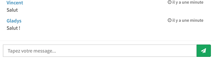

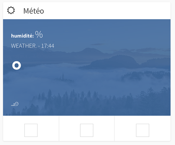

I don’t know if it’s related, but my weather widget isn’t working very well either since the beginning:

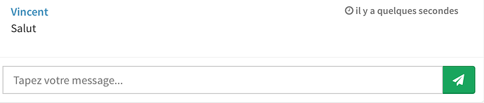

And when I talk on Telegram, I have to refresh the page to see the response.
Refresh:
Oh dear..

For the weather station, are you using HTTPS?

I’m not sure if I saw the tutorial for HTTPS though :confused:
