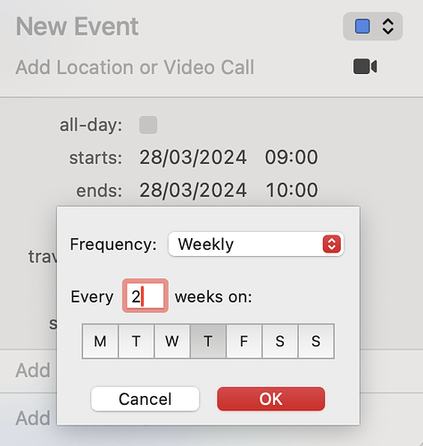

I think a good way to do that right now is to use the Calendar in Gladys:
  • You connect a CalDAV calendar in Gladys (Google Calendar, Apple Calendar, or even free services like fruux — it works very well)
  • In your calendar, you create your events. Imagine you have a « foot Â» outing every other week, you create an event that repeats every 2 weeks, for example in Apple Calendar:

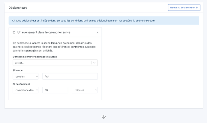

  • In Gladys, you create a scene that triggers on a Calendar event:
this lets you make a scene that triggers 30 minutes before the start of your « foot Â» event that repeats every other week :slight_smile:
I think the calendar is often more convenient for scheduling tasks, and then you have a « fixed Â» scene that never changes.
