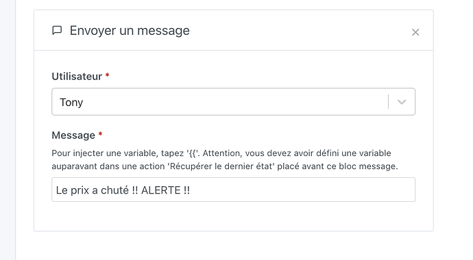

Of course, it is also possible to use the data in the « continue only if » box:
:flushed_face: It’s super clean and exactly what I had in mind when writing this topic!
