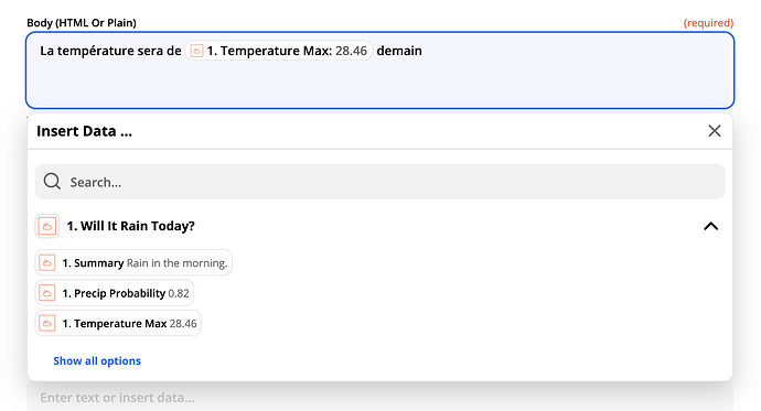

For the variable injection part into other scene fields, I would like to do something like Zapier does:
For example, this means that in a « send a message Â» action in the scenes, you could draw from data that has been retrieved by another action (retrieve a device value, HTTP request, etc…)
Problem: I tried to break down how they do it, and it looks tricky! they have a fake textarea that is 0 px and on top of it a kind of pre - code tag to display the text set at the same time as the « styled Â» variables (since it is not possible to have style in a classic textarea)
Does anyone know HTML/CSS and could do something like that with preact? :smiley:

Hello @wazalop, I was just talking about frontend development, how to visually do in HTML/CSS the screenshot I posted above :smiley: I have the data!
