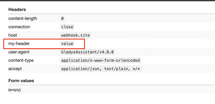

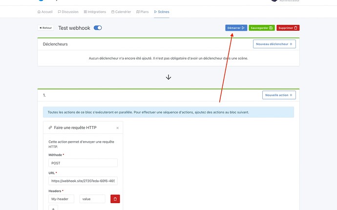

Ah indeed! By the way, quick fix in the meantime, in my opinion @Checconio if you test your scene by « running » the scene instead of « trying » the HTTP block, it should work.
Indeed, it’s another project! After that, we are not obliged to send the real values in a « try », we can just send a placeholder for the variables. If we put a message to say that the variables will be replaced by test values, I think that can already be good :slight_smile:
I confirm the « hack » while waiting for the « try » bug to be fixed. If you test the scene via the « Start » button global to the scene, it works well:
