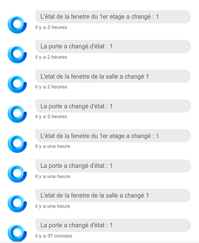

I just looked at the Zigbee logs and I do indeed see true values popping up from time to time, not false then true.

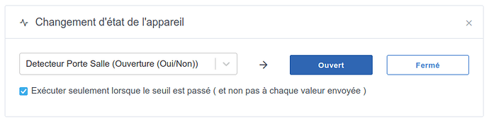

Does that mean that if I check the box:
That should fix the problem, right?
I had set up a message in the Gladys discussion as soon as there was a state change, specifying it in there, and you can clearly see 1s everywhere.
So it wouldn’t be related to their installation, which in this case detects the changes correctly.
Ahhh yes indeed, that could be it. Your sensor just reports its state, but as long as that state hasn’t changed there’s no point in triggering your scene. So you need to check the box, indeed ![]()
