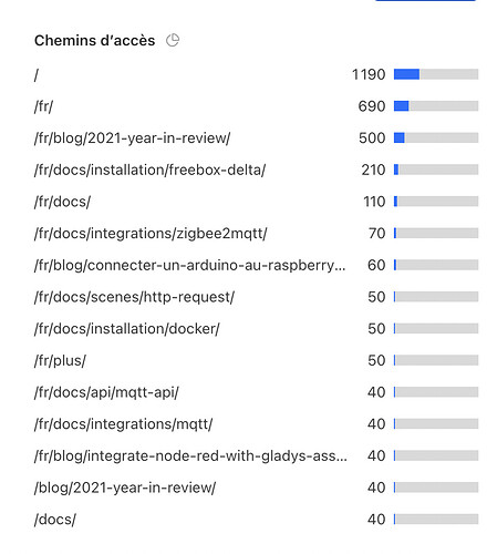

Still with the aim of growing the project, I would like to improve the installation documentation for Gladys, especially for installations outside of Raspberry Pi.
It’s simple, but for example the tutorial « install gladys on a freebox delta » brings a lot of traffic from Google:
It’s simply the most visited article, without any ads, the power of SEO ^^
