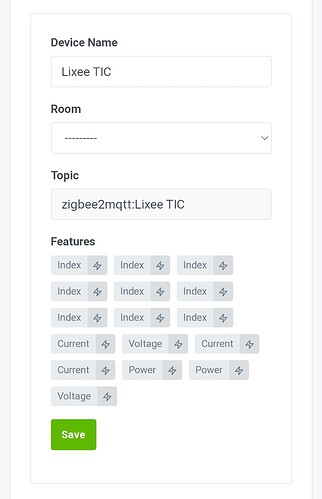

@VonOx
Does the Lixee module show up in gladys or not? I was thinking of buying it.
Thanks for your reply.
I’m in the process of adding support
@jerome are you single-phase or three-phase?
@camille also has this module, I think
Hi, I’m interested too, I’ll order it soon, I was waiting for it to be integrated into Gladys.

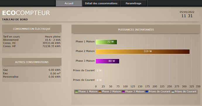

Edit : On my side I currently have a Legrand Ecocompteur (works over RJ45 and you can connect 5 toroids for the power measurement points - costs 150€) connected to the teleinfo which actually works quite poorly, it rarely displays the data on the interface and/or shows incorrect data (I have a 1 kVA contract ^^) :
[details="Configuration screen - you can see

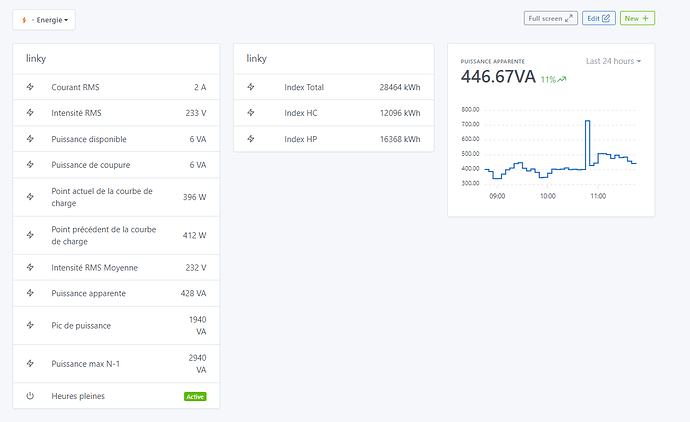

Exactly, for me it’s the Zigbee plug-and-play module
A sneak peek, it’s coming along nicely
