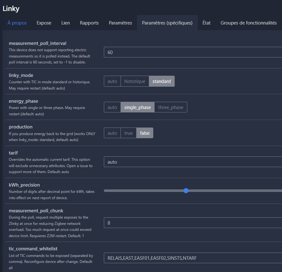

For those who already have the pairing module, I strongly recommend that you configure the TIC (teleinformation) according to your needs.
  • Whitelist the info you want to retrieve
  • Reasonable poll interval
  • Poll chunk with a value corresponding to the number of commands in the whitelist
Example:
My configuration
What is exposed:

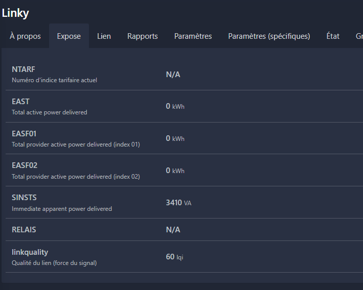

Following the last call to the community, I bought the Lixee module. I’m on single-phase, with an off-peak/peak (HC/HP) tariff, but it seems the data aren’t coming through on my end…
Any idea what’s wrong? Has anyone seen this behavior before?

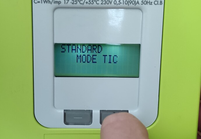

Are you sure you’re in standard mode?

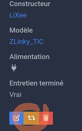

Also, did you reconfigure the module after changing the options?

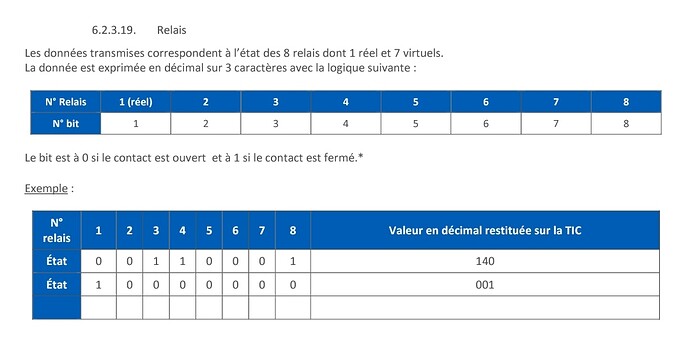

I also removed the Relay; I don’t know what that corresponds to :thinking:
Ah, damn, good catch — I was in historical mode :sweat_smile:
But I didn’t understand the reconfiguration thing — what does that refer to?
Basically, a restart of the device is needed to apply the settings.

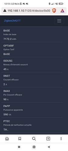

For historical mode, the information is in other « expose ».
That corresponds to what you have on your meter.
To switch to standard mode, you can request it from your energy supplier.
  • The « historical » mode. Enabled by default, this mode transmits data equivalent to those sent by the TIC of legacy meters. The historical mode thus ensures compatibility of connected equipment when replacing an electronic meter with a Linky meter.
  • The « standard » mode. It transmits the « historical » mode’s data at a higher transmission rate and in a different format, and
Indeed, after a reboot and removing the filters it seems to work much better, looking forward to the integration on the Gladys side, thanks for the work and the advice!

Yes, but the famous « measurement_poll_interval » — that’s common to all installations, right?
Default is 60 seconds, I had a different value because I have the TIC before official support
