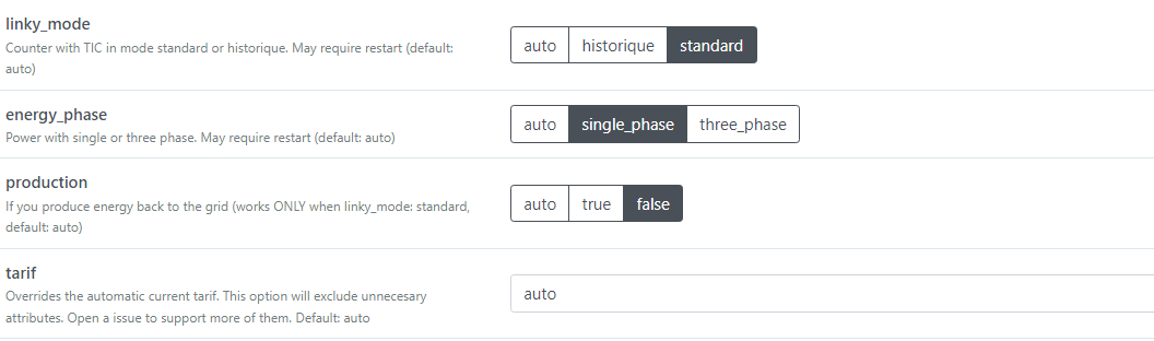

The device exposes the following by default:
ADCO, BASE, OPTARIF, ISOUSC, HCHC, HCHP, BBRHCJW, BBRHPJW, BBRHCJR, BBRHPJR, IINST, IINST2, IINST3, IMAX, IMAX2, IMAX3, PMAX, PAPP, PTEC, DEMAIN, HHPHC, PPOT, PEJP, ADPS, ADIR1, ADIR2, ADIR3, LTARF, NTARF, VTIC, DATE, EASF07, EASF08, EASF09, EASF10, EASD01, EASD02, EASD03, EASD04, EAIT, ERQ1, ERQ2, ERQ3, ERQ4, URMS1, URMS2, URMS3, STGE, PCOUP, SINSTI, SMAXIN, SMAXIN-1, CCASN, CCASN-1, CCAIN, CCAIN-1, UMOY1, UMOY2, UMOY3, SINSTS2, SINSTS3, SMAXN2, SMAXN3, SMAXN-1, SMAXN2-1, SMAXN3-1, MSG1, MSG2, PRM, DPM1, FPM1, DPM2, FPM2, DPM3, FPM3, RELAIS, NJOURF, NJOURF+1, PJOURF+1, PPOINTE1, linkquality
80 features
By setting its contract type it removes a large portion of them (there is now an auto mode)
Also, if there are too many unnecessary exposed items you can whitelist
Which gives me 7 features
