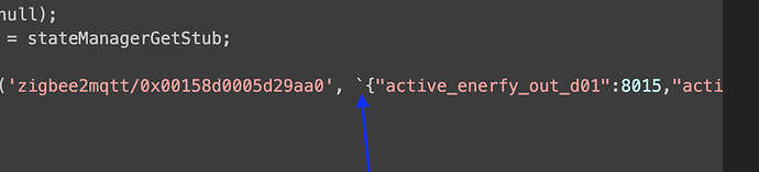

Is that in your code or is it a copy-paste error on the forum?
In the code, I will replace it with a single quote.
Ah, but wait, it’s actually supposed to be a string, I guess, so that might be normal.
What error are you getting otherwise?
Yeah I just checked the other tests, they’re like that
