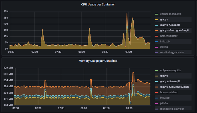

Gladys is slow!
Impact on performance
My server can handle much more, but the interface is slow

Out of curiosity, do you have a lot of scenes or not?
No, some are inactive
![image|690x434](upload://a6OpUNCX0iJOlO
Ok, whether active or not, each scene will be « iterated » to check if it is active or not, so it still has an impact
