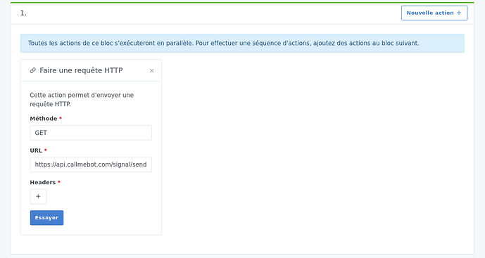

For this, make your scene, in the actions to be performed you have this:
You create a new action and then configure it like this:
The URL is composed as follows:
https://api.callmebot.com/signal/send.php?phone=+336XXXXXXXX&apikey=XXXXX&text=Ceci+est+un+test

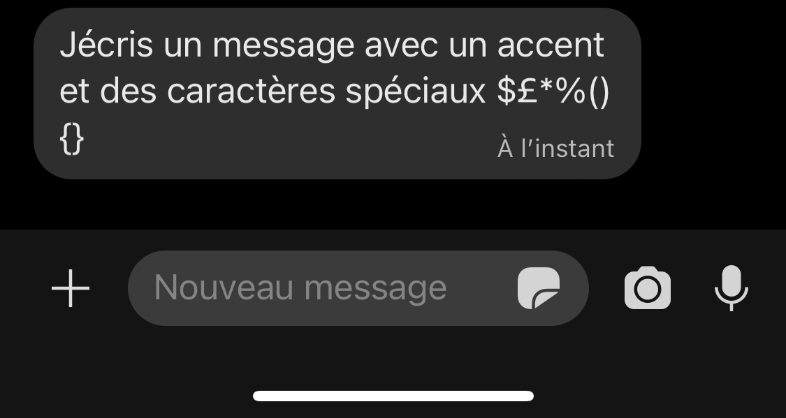

We execute the scene and the bot sends us a message directly on Signal.

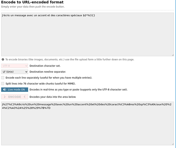

To be able to make more « complicated » messages, you can go through this site for example: https://www.urlencoder.org/
To make it simple, we will « encode » a sentence so that it is compatible with an http request.
We can see that the message has been « transformed » with a lot of %. It’s normal, it will be read correctly.
Here is the result:
