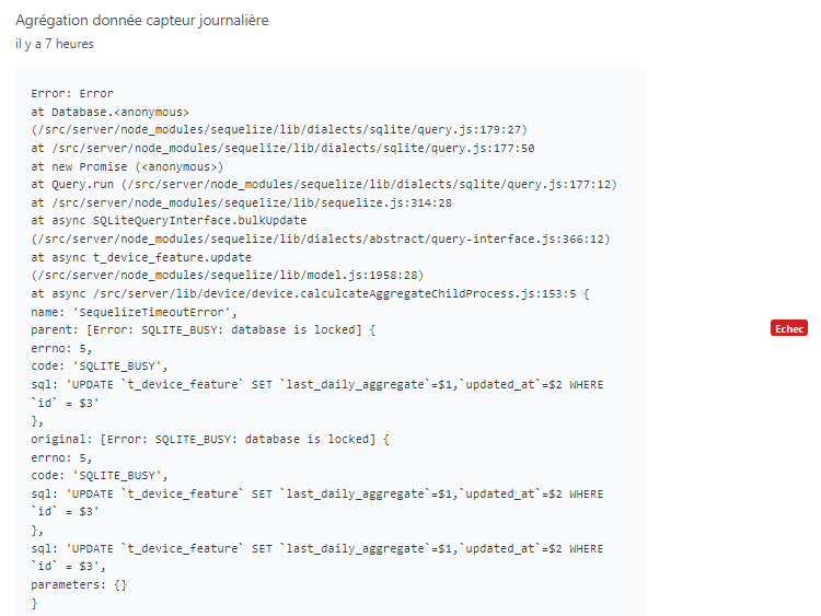

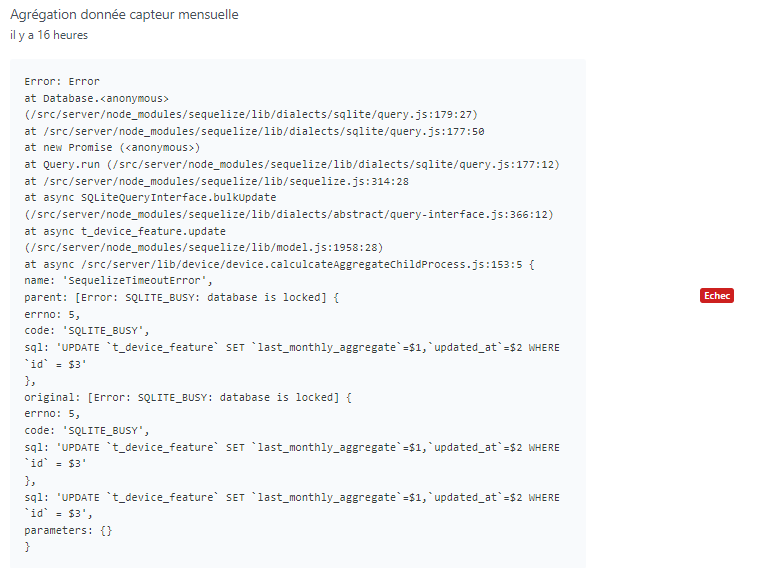

Aggregation errors in the "Background Tasks" tab

I’ve gone over my problem from every angle, reduced my setup to the bare minimum and I

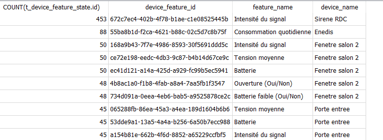

One option you can do would be to grab the SQLite file and run a small SQL query to determine which device sends the most values!
The DB is located at:
/var/lib/gladysassistant/gladys-production.db
Make sure to stop Gladys before retrieving the file to avoid any corruption.
Then, copy the file to your local computer (outside Gladys), and with a tool like TablePlus run the following query:
SELECT COUNT(t_device_feature_state.id), device_feature_id,
t_device_feature.name as feature_name, t_device.name as device_name
FROM t_device_feature_state
JOIN t_device_feature ON t_device_feature.id = device_feature_id
JOIN t_device ON t_device.id = t_device_feature.device_id
GROUP BY device_feature_id
ORDER BY COUNT(t_device_feature_state.id) DESC;
That will give you the most verbose devices :slight_smile:

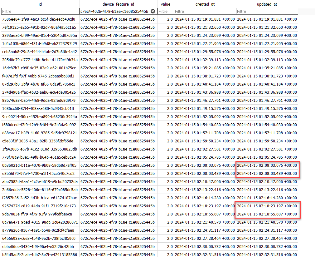

Thanks @spenceur and @pierre-gilles
It seems the matter is settled. It’s this one NEO NAS-AB02B2 control via MQTT | Zigbee2MQTT
Is there anything I can do to reduce the amount of information being reported?
How old is your instance? 453 values is nothing :smiley:
The idea here is to calculate how many values/second Gladys receives to see if a sensor is really extremely aggressive, but 453 values, if that’s over a few days, is really nothing.
You can go look at the t_device_feature_state table and filter by that sensor to see how frequently it sends, but that seems totally fine to me…
The most recent fresh install was 20 hours ago.
Apart from the fact that it stutters from time to time, I don’t see anything abnormal either.
The last failure occurred at around 2 a.m.
Ok, that must be the time your system performs its backup via Gladys Plus, nothing abnormal!
Do you only have a single failure per day at that time?
Yesterday morning, and for several days, I had only failures.
Fresh install directly on the NAS (no VM), with the dongle plugged directly into the NAS (no USB hub), I re-paired all my devices and ended up with only failures again.
I therefore opted for a minimal install.
Since then I’ve had two failures: the one from last night and another yesterday, 4 hours after the install

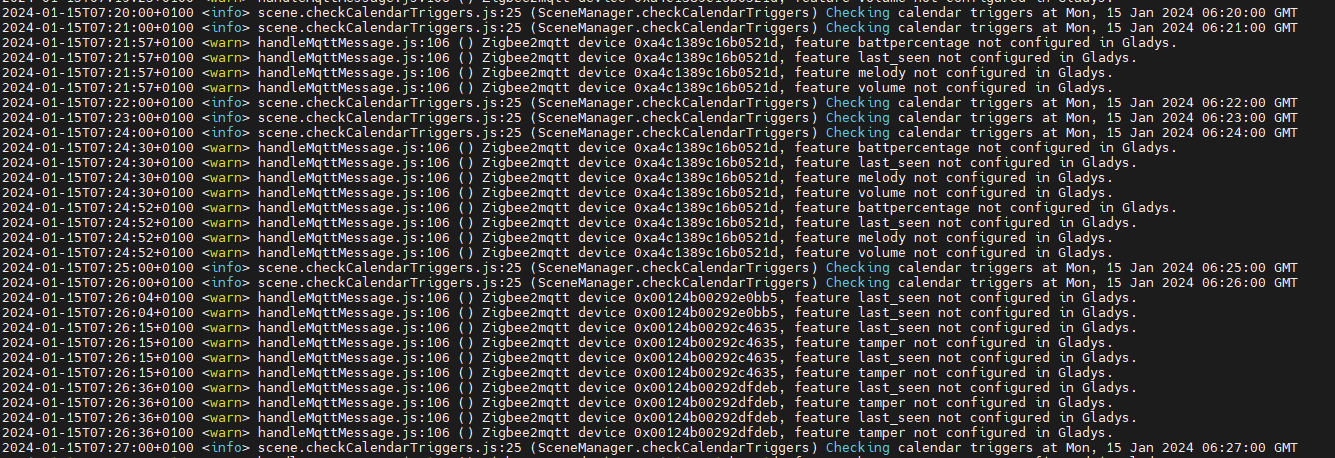

I also notice these messages in the logs indicating that certain features of the siren are not supported, but I doubt this is blocking.
Ok, that’s indeed not normal.
Those are perfectly normal log messages, nothing blocking :slight_smile:

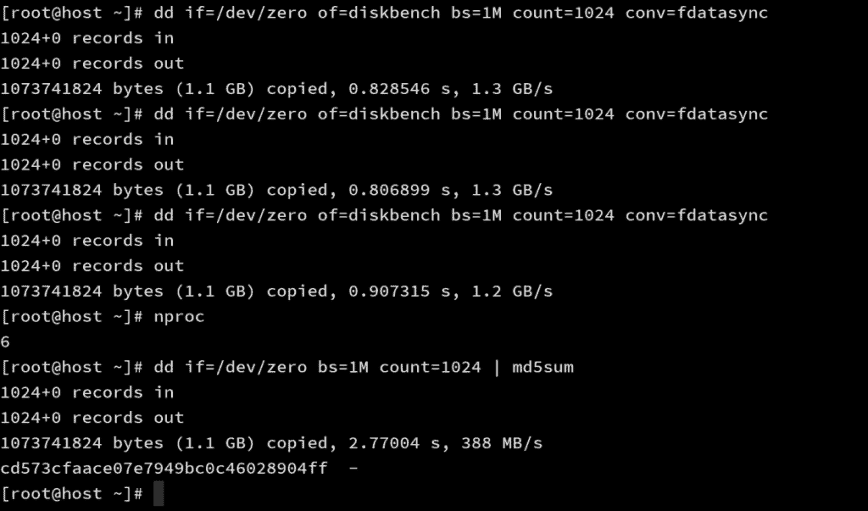

Have you already done a quick performance test on your NAS? The disk part in particular?
I recommend this article:
Look at the disk write/read test section
I’d be curious to know the performance of this NAS!
Here you go
DiskStation® DS1621+ | Synology Inc.
Ok, that seems normal. Not exceptional but not bad at all :slight_smile:
Is it an SSD? SSD NVMe? HDD?
And on your NAS there are things running at the same time I imagine? Nothing that could occupy the disk « to the max » and that could block Gladys?

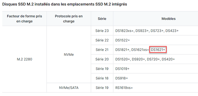

Can you connect an additional drive? If not, add an SSD (not in RAID) and put the Docker Gladys volume on it — at least you’ll be isolated and on SSD :wink:
If there’s disk activity during aggregations, that’s normal :slight_smile:
Since I was going to add an SSD I ordered an NVMe in the M.2 form factor which I’ll use as a cache for the entire RAID array, thanks for the tip! I’m lucky to have a model that supports it.

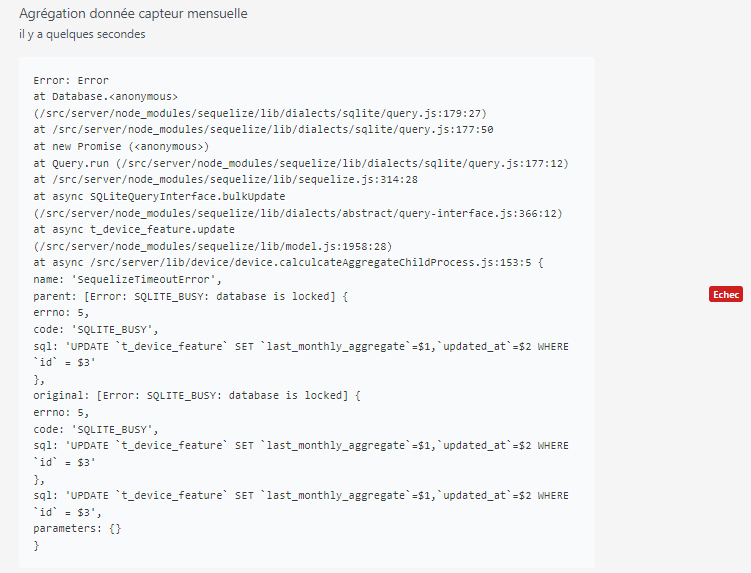

After adding I waited 10 mins and restarted Gladys to force the aggregation :
I deleted the device, cleaned the database, restarted Gladys and the aggregations work like a charm. It therefore seems that this device is causing the problem.

Lots of tests in mind to find the root cause, the first being adding an NVMe cache to my NAS. I did order a first NVMe in M.2 format but just learned that you need 2 for the cache to be read/write and not read-only, so I ordered a second.
