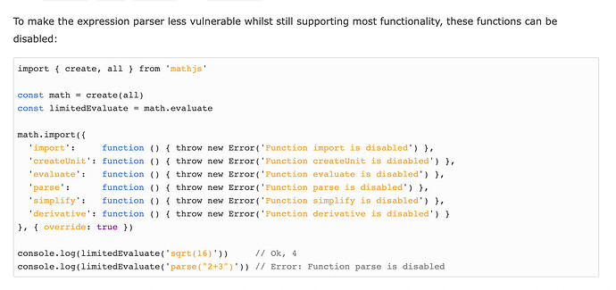

In fact their explanation is rather reassuring; they clearly state that they did not use eval to evaluate operations, and that they implemented their own evaluator. They warn about the risks!
Their example is actually very good — it is possible to disable functions:
In our case, in my opinion we should make a list of the functions we want to support, and then harden the unit tests to verify that it is indeed only those functions that are supported.
