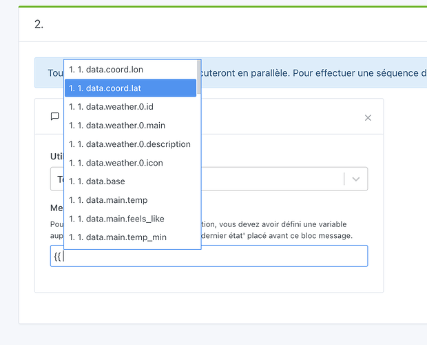

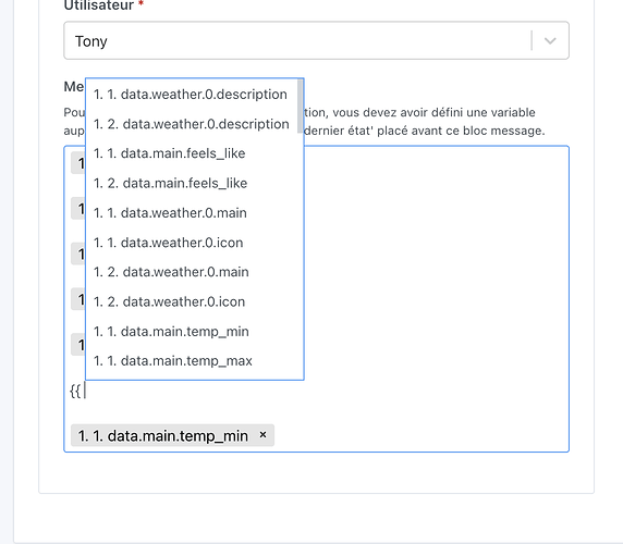

I tested your PR, and I get this:
Before:
After:
The boxes are mixed afterwards, which makes it really difficult to use.
Aren’t these two different issues related to the ticket?
