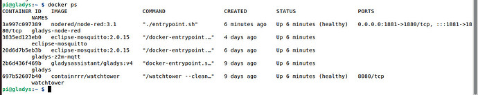

J’avais started the Node-RED installation while connected by Ethernet cable
on obtient cela
I create the Flows, everything works.
I disconnect the Ethernet cable, reboot the Raspberry Pi and then if I run docker ps there is no line for Node-RED

The integration in Gladys does not reflect the real state of the container, I think the container is removed and
Thanks — I had tried to restart it, but I had used run instead of start, so it didn’t work.
Cependant as mentioned above, it’s for my parents’ place, Gladys Assistant opens in full screen (kiosk mode) so I can’t imagine telling them if there’s a power cut they have to press Alt+F4 to kill Firefox, then open a terminal and finally type docker start gladys-node-red.
With the manual installation the node-red Docker restarts without any problem, so that works for me.
Great, afterwards node-red should work correctly; for now there are still some glitches, the integration does not reflect the container’s actual state… but this will be resolved in the near future, for now if you have node-red features that run better it’s better to use a manual installation or consider backing up your flows
