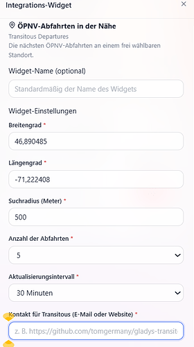

The widget configuration only comes when adding the widget.
  1. Currently, only one location can be displayed; you need your geolocation.
  2. The other values are self-explanatory, so keep the search radius at the beginning between 100 and 2000 meters, the display of max hits is up to Gladys. That’s all.
  3. You still need a unique identifier (requirement from Transitous). I simply use my email.
  4. I still need a better image.
Here is the configuration:

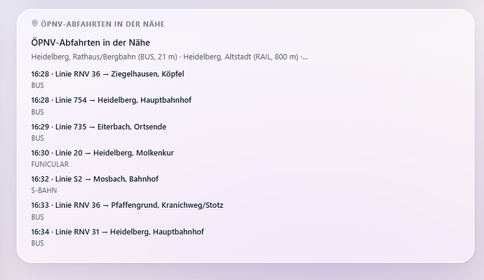

You will receive a widget with the following basic functionality:
Based on the geolocation, bus stops are searched up to the search radius. The nearest bus stop is taken and then the next departure for this bus stop is displayed.
Buses, rail-bound trams, S-Bahn, ICE, TGV, cable cars, ferries in scheduled service and other means of transport are displayed. The names of the stops and their distance appear at the bottom.
The departure times then appear in the tiles with time - line name - destination
In other words: In the countryside, the user takes a larger search radius and, for example, gets the output of the nearest bus stop in 500 meters and the nearest train station in 2000 meters.
Conversely, a city dweller, for example, only takes a search radius of 100 meters, as he only needs the next departures of the bus stop in front of his house.

Thank you for the integration. I see a fundamental need for this at home. However, I tested it yesterday and received instant feedback from my wife that I didn’t want to withhold from you (and I agree with her :)). A screenshot is attached for illustration.
Design and UI
  • The information is correct, but visually hard to understand. Where does my train to Regensburg depart from? No information about that. Where do my buses depart from exactly? We have 6 stops here.
  • Suggestion: Could you not group by stops/stations/airports, whatever, and then put the respective cards underneath? Then you also know at which stop the good thing departs. (possibly behind the stop, then the distance), then the list below becomes obsolete
  • The button label is too technical. Why not call it « Expand search radius Â»? And possibly make it optional in the widget configuration. I don’t need it, for example, and it just takes up unnecessary space.
I quickly threw something together here to show you what I mean. In this context, you could maybe use a different separator from the « - Â», for example the middle dot and handle it with spacing, so that it has some room to breathe. I’ve attached 2 suggestions for you. The second suggestion would be to bring more hierarchy into the card.
