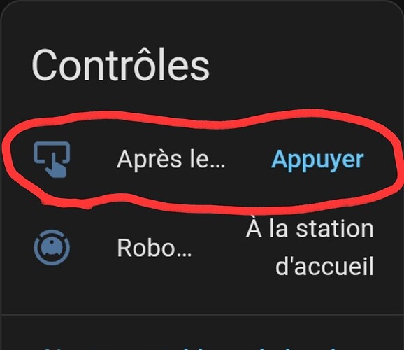

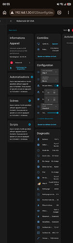

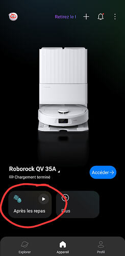

On roborock you can create routines (shortcuts) with actions like the type of cleaning etc.
Via HA you can launch these routines and currently on gladys you can’t. By the way, there is also a system for mapping rooms between HA and roborock etc. Here’s what I have for example on HA.

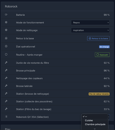

Hi, I started adding the returns from the different sensors.
I also added the dock because it itself has information depending on the vacuum cleaner.
For some features, I went through the unknown category and the unknown type

I updated the integration to 0.12
It now supports consumables for the dock and the robot as well as room selection for cleaning
