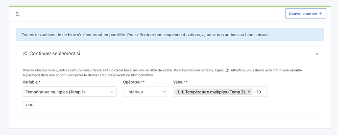

I don’t know if you saw in the screenshot, I planned to add in this PR the ability to put variables in the value of the « Continue only if » block, isn’t that what you’re asking for?
Yes, we can add round to nearest, round up and round down — it could be useful to have all three. Good point about modulo, I’ll note it
It’s not necessarily a request for me, but the « continue only if » is correct.

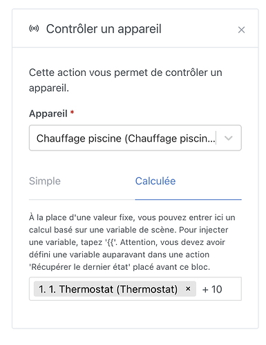

The PR is here
The code allows using variables and performing calculations in scenes for the « continue only if » and « control a device » blocks (see screenshots a bit above)
If you want to run tests, an image is available here bertrandda/gladys:scene-var-eval

Quick question:
Could the result be used to ‹ control a device ›?
Yes :slight_smile: Look at my screenshot above

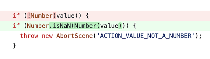

@bertrandda For info, @AlexTrovato found a regression in this feature — if a device control ever sent a value equal to 0 (very likely, because 0 is « OFF » for all devices), the scene would stop :grimacing:
Fortunately it didn’t make it to production and he made me a PR in time! :smiley: Thanks @AlexTrovato!
The fix: Fix zero as a number by atrovato · Pull Request #1773 · GladysAssistant/Gladys · GitHub
