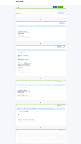

Here’s what it looks like:

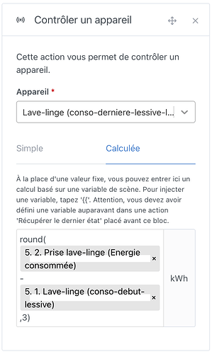

you can test with the following; it should do the trick.
round(Prix_du _kWh * consommé_en_24h,2)

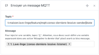

That’s what I had tried in a block, but maybe it simply wasn’t the right one (to send an MQTT message).
In the end, that was it. The MQTT block does not take calculations into account.

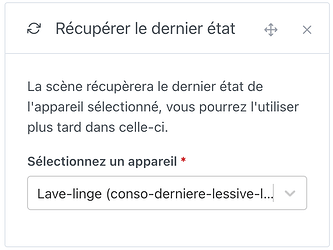

There is a subtlety that @prohand pointed out in his tutorial washing machine.
Il faut créer un capteur et un actionneur :
