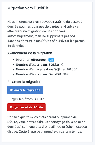

    SequelizeTimeoutError
    SQLITE_BUSY: database is locked
For example:
Unable to reset failure count of integration ...
The HTTP server itself continues to respond on port 8455.
DB Configuration
The SQLite database is quite large:
gladys-production.db        ~12 GB
gladys-production.db-wal   ~1 GB
gladys-production.duckdb   ~1.9 GB
SQLite is running in WAL mode:
PRAGMA journal_mode;
wal
A passive checkpoint works:
PRAGMA wal_checkpoint(PASSIVE);
0|227|227
Simple queries on SQLite remain fast:
SELECT COUNT(*) FROM t_device_feature;
446
real 0m0.090s
And:
SELECT COUNT(*) FROM t_device_feature_state;
0
The states therefore seem to have been successfully migrated to DuckDB.

Continuing the analysis, I realize that you have a lot of aggregated states in t_device_feature_state_aggregate that are no longer used. Everything is in DuckDB (states and aggregates calculated on the fly).
I think that the purge here only purges the states and not this table:
It might be better to delete the data and not implement the fix on a table that is supposed to be empty. I continue the investigation :detective:
I suspect you still have some unpurged aggregated states. I opened a PR to display them here Show the remaining SQLite aggregates in the DuckDB migration card by cicoub13 · Pull Request #2952 · GladysAssistant/Gladys · GitHub
But if you don’t want to wait, I think clicking the Purge button, then Clean the SQLite database. Your Zigbee update issue should disappear
I don’t understand, I already did this when DuckDB first arrived
I just clicked on purge and now I’m frozen again
I feel like I’m stuck..
To unblock myself, I need to purge, but to purge, I get blocked ahah help :face_with_spiral_eyes:
I think you never let it run to completion. Click Purge at a time when you don’t need Gladys and let it run. Even if you don’t get visual feedback, the purge is happening.
