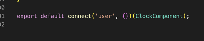

Stop using the @connect decorators used by unistore
That was trendy at the time and in the end unistore no longer recommends it; it was a « hack » allowed by the transpiler, I don’t even think it’s in the JS spec in 2023.
Before:
Now:
I need to add an ESLint rule to ban this behavior.

I started a PR to add a warning about using the @connect decorator (and replace it with the function call)

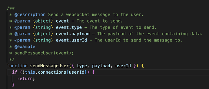

@Romuald_Pochet Yes, those aren’t function parameters you’re describing, it’s an object!
So you should do it like this:
Also, small feedback, the = undefined isn’t necessary, because if you don’t specify an orderDir, it’ll be undefined anyway :slight_smile:
