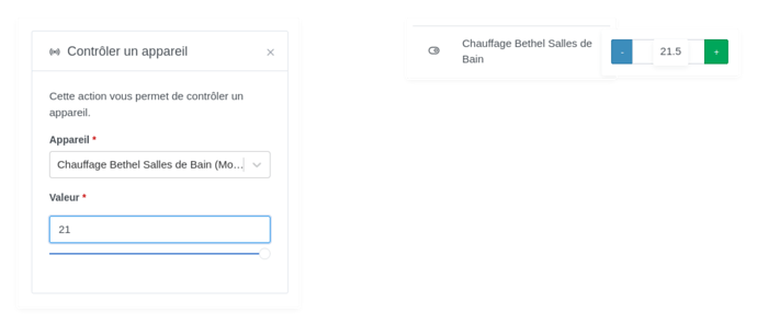

From what I understand from all our discussions, there’s for the moment only one thing left to agree on: how we want to present this in the dashboard?
Do we want a slider like the brightness control?
Or a thermostat somewhat like this, increasing in 0.5-degree increments?

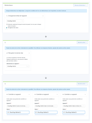

Here’s what I see for the moment
Left side in the scenes, right side in the dashboard
If it’s that simple, even better!
That said, do we want to do « device by device » (which could be a good start at first), or do we want to offer controls rather by room? (which could come in a separate box later on)
In any case, I’m in favor of keeping things simple to start, and what you’re proposing is really pretty good!
Yes I had the same thought, but for me object groups are another topic, no? You might want to create an object group with the lamp plug and the ceiling lamp to always turn them on together, so do we want to restrict that to heating only?
I think the best trade-off on this point would be to be able to create an object group in a scene very easily like this:
or every change in the value of a type can be propagated to another object of the same type.
What do you think? And this is a big core feature of Gladys
or we can do everything in a single block in the scenes, which allows displaying only the devices that are compatible with each other
We’ll see, we’re not obliged to always make it generic; sometimes a custom one for a device type can be good too!
