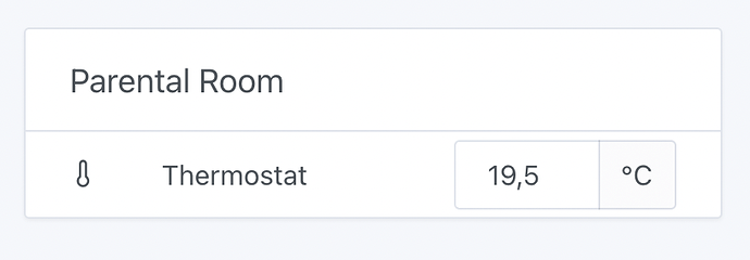

For now I can offer a direct control of a device in the UI:
Can be increased by clicking in 0.5 increments:

One remark: on PC it’s fine, no problem, and it will suit me at first to set the value, but on a phone or tablet I’m afraid the adjustment buttons will be too small! Right?
