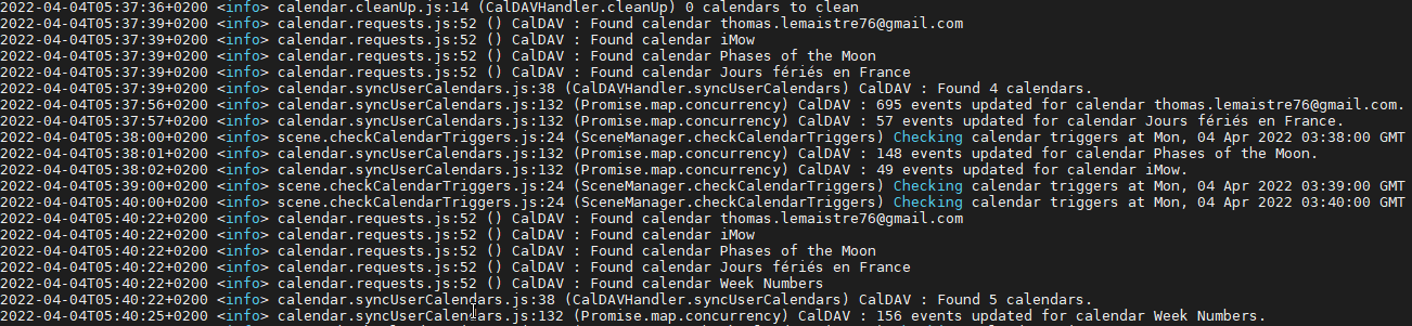

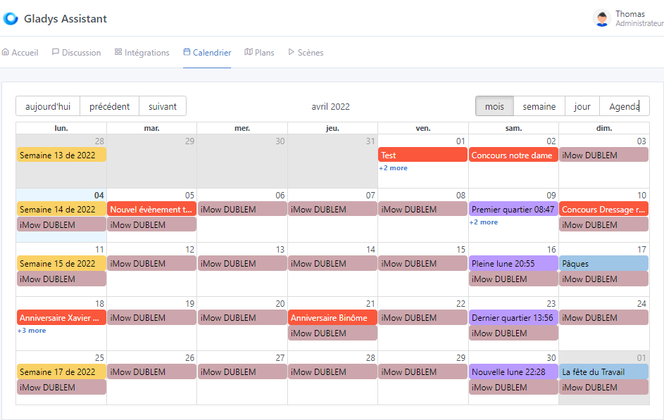

Magnificent, that’s a good wake-up call at 5:00 am :wink:
It works perfectly, I even recover the week numbers again :blush:
A big thank you to you for the work accomplished!! (We absolutely need to set up a coffee offering system for the devs ^^ I think about it for many developments or dev evolutions, but there is no simple way… @pierre-gilles ^^)
As a result, I validate the test part on my side, no more errors. I have just set up scenes on events from different calendars, I will let you know if something goes wrong.
Edit:
I confirm that all scenes also work perfectly

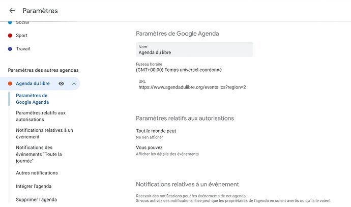

Hi @bertrandda ! I just tested your PR by trying to add a webcal calendar to my Google Calendar, but it doesn’t seem to work, I might be doing something wrong..
I added in the settings of my Google calendar the webcal « Agenda du libre »:
I’m syncing on the Gladys side, but it doesn’t add anything to Gladys
Do you know if it works with Google’s CalDAV implementation?
I think that by default Google does not enable webcal synchronization (they do the same for shared calendars). Can you go to this link, see if you can enable syncing of your webcals and restart the sync on the Gladys side?
Indeed, that was it!
But I’m not sure this actually tests the feature — I think Google includes these events in the regular « CalDAV »:
