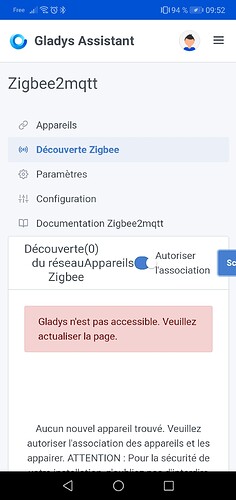

Hello @VonOx,
I’m unable to sync my opening sensors with Gladys on my end.
I tested on about ten of them but nothing on Gladys’s side.
I pressed for 5 seconds to put it in pairing mode.
Did I miss something?
Everything is green on the configuration side.

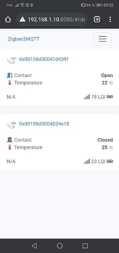

pi@raspberrypi:~ $ docker logs gladys
As you can see, they are indeed on the Zigbee interface

I also reproduce this via G+ / on LAN / Mobile or PC
EDIT: There is a cache issue because by forcing a page refresh, I got my discover to work
I just realized that the issue occurs when I’m on Gladys +, locally via the IP address, I have no problems
And of course, before coming to you, I did several hard refreshes and even ran CCleaner to be sure

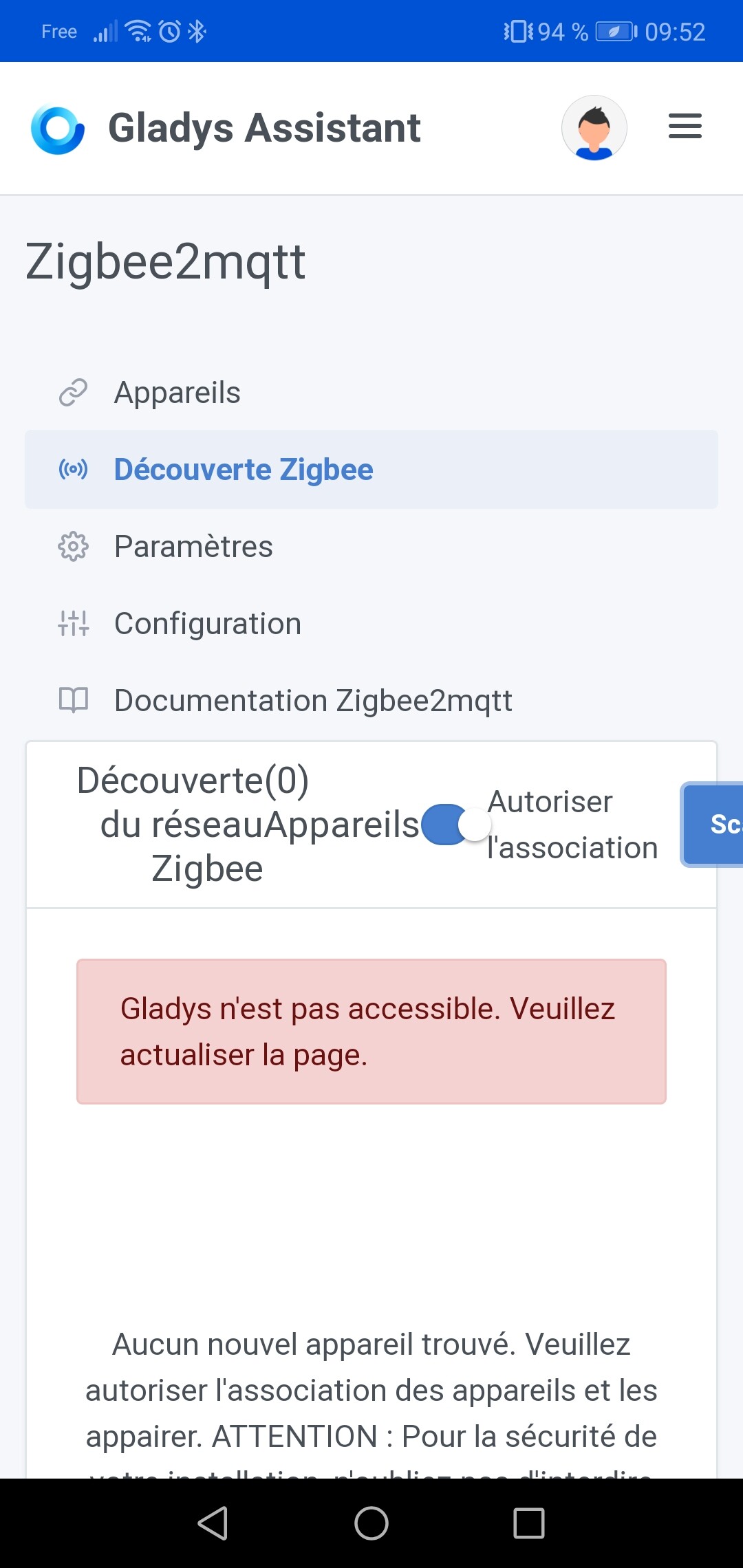

I have often noticed connection losses related to the websocket (no connection to the Zigbee2mqtt service). But as the device reporting during the scan uses this protocol, sometimes it is necessary to reload the page to reconnect the websocket.
For Gladys Plus, I have not been able to test it, but the events should be reported in the same way as locally.
Could you check in the browser console if there are any specific errors?
Well, the page’s responsiveness isn’t great either ^^
@cicoub13 what does this message « Gladys is not accessible Â» correspond to? As it is, it gives the impression that Gladys is down, and I imagine that’s not the case, maybe the wording should be improved
Are you sure the issue only appears in Gladys Plus and never locally? From the messages I read, it looks more like an instability issue that sometimes works and sometimes doesn’t, regardless of whether it’s local or Gladys Plus (my impression)

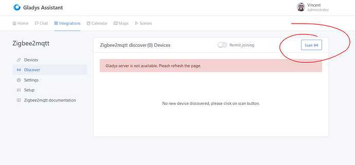

@VonOx have you managed to get the Zigbee2mqtt integration to work at least once on Gladys Plus?
I confirm what @Jean34 said, it works locally but not via Gladys Plus
I don’t know if it worked because my z2m configuration was done locally and via laptop for more comfort.
Devices already added work on the dashboard via G+.
No errors in the console
In our tests, we realized that sometimes the socket used would no longer respond and thus cause the scan to fail after several seconds.
To better manage this error, while waiting to resolve it definitively, I imagine, this error message was put in place to ask to reload the page and restore the socket.
Ah! Ok, I’ll investigate. What exactly isn’t working?
The scan in discover
I often have the same problem, but it seems to me that this problem only appears locally due to the server’s hot reload. Do you have the same problem in production? (in which case, it’s not normal :p)
Ok thanks I’ll check
Ok, I found it. The Zigbee2mqtt integration code is based on an attribute not implemented on the Gladys Plus front end, it couldn’t work.
I’ll code the thing!
I can confirm that this problem only occurred when restarting the Gladys container in my tests.
It has never happened to me since it has been in production, as far as I remember.
