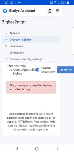

That’s what I thought right away, but the Gladys container is indeed active.
Yes, I just did it again :slight_smile:
I did the installation/configuration of z2m via Gladys +
No errors in the Mozilla console
This corresponds to the fact that the websocket is not connected (and therefore the scan will not work).
Oh great, don’t hesitate if you need help.
I’m running locally, and as mentioned, I haven’t been able to detect my devices yet.
And indeed, if we can change this error message, it would be great because it’s not understandable.
The issue is that the message suggests that Gladys is down, which is not the case.
If there is really a websocket problem, I think we should address the real issue rather than asking the user to perform manipulations :slight_smile:
@Tlse-vins Do you have this error message locally, with Gladys v4.2.3 in production?

Yes, that’s exactly it.
Ok.. do you have a special network configuration, a company proxy that would block WebSockets? ^^
After refreshing the page, does it work again or not at all?
Nothing unusual on an Orange box.
After a refresh, the message disappears and comes back from time to time, but I still can’t find my sensors.

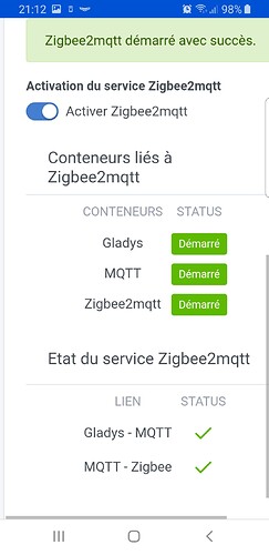

Is everything green in Configuration (all containers and links)?
If you can’t access port 8080, I think the zigbee2mqtt container is not running. And consequently, your devices are not associated with the Zigbee network of Gladys.

What should the message have said? « Connection to Gladys Backend is lost? Â»
I didn’t want to go into technical details.
After that, I agree with you that we should always look for the source of the problem and fix it first. But I wanted to handle all error cases.
Yes, that’s the case. (I will take a screenshot tonight)
Same, I will check tonight but I think I had everything activated.

Where I think there is a problem is that the zigbee2mqtt front end is based on the variable « websocketsConnected Â», however this state is dynamic (the websocket connection disconnects naturally and then reconnects quite regularly, which is quite normal), however if the websocket reconnects, the zigbee2mqtt discover view will remain in a « broken Â» state. I think it’s just a lifecycle problem.

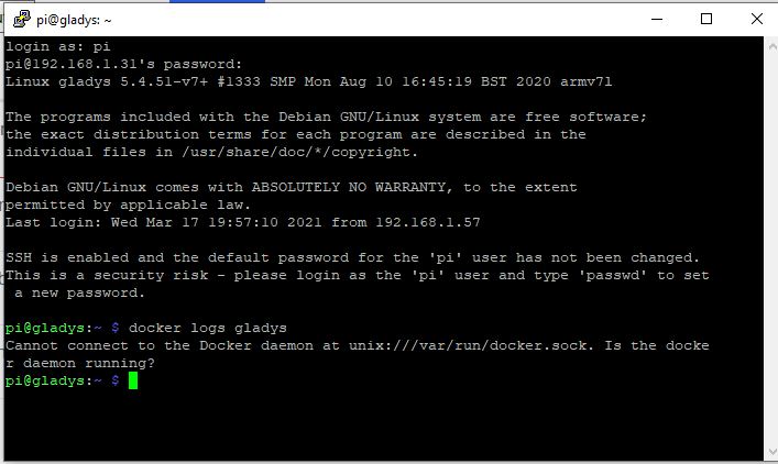

The only difference I have is that I installed Gladys on a USB key.
As for the logs:
Oops, it seems there are some issues with your installation :sweat_smile:
Should you create a specific topic on the forum to discuss this? I don’t think there’s necessarily a link with the Zigbee2mqtt integration here, if the Docker daemon isn’t even accessible, the Zigbee2mqtt integration is not likely to work either ^^
In my opinion, there is a problem with your USB key setup
@Tlse-vins
The docker command is reserved for root or those in the docker group.
Try adding sudo before your docker command. If it still doesn’t work, it’s because docker is not started.
No Docker starting.
I will open another post.
