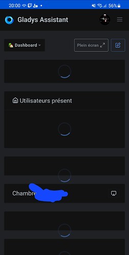

Hello, since the last update I have display issues with the dashboard on gladys plus only.
Am I the only one?
Locally, however, no issues :frowning:
I’ll pull the logs when I’m on a PC ^^

Well, in this case I don’t think so (I have the issue on mobile :frowning:)
Sometimes I refresh and I get my buttons, but if I turn on a light or deactivate my alarm, nothing happens — I have to refresh and click again. :frowning:

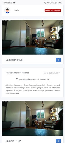

As you can see, both the HLS and RTSP streams. If we compare the time displayed in the stream with the one shown at the top of the phone, we quickly notice that RTSP has less latency.
But no more buffering problems.

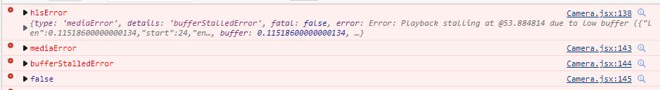

I tested again via Gladys Plus and I confirm that the RTSP streams are smooth while the same HLS (.mp4) streams buffer quite a bit.
I also got this error, I think it’s related:
Ok great! RTSP latency is actually pretty good :slight_smile:
Indeed, doing HLS on top of HLS doesn’t make much sense and causes buffering. The error you’re seeing is indeed a buffering error :slight_smile: stick with RTSP!
