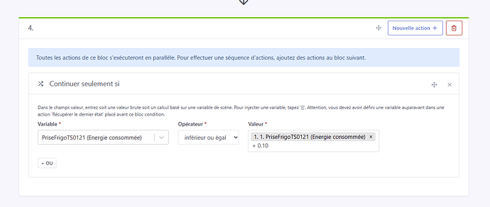

I’d like to make sure I’m using the calculations correctly, because I can’t get what I want to work.
Goal
Alert when my fridge consumes more than 0.11 kWh in 30 minutes. That means the freezer or fridge door stayed open and it’s overconsuming to try to compensate for that loss of cold.
Means
A smart plug sends the instantaneous consumption value as well as a total consumption value that increments slowly, in kWh.
My scene
Description : Every 5 minutes, the scene runs:
  1. Retrieves at T0 the total consumption value, for example « 1100.05 kWh »
  2. Waits 30 minutes
  3. Retrieves at T30 another value, for example « 1100.10 kWh »
Then I need to calculate the difference to check that I haven’t consumed more than 0.10 kWh in 30 minutes.
But, this is not a calculation possible to do as is (if my calculation > value), you have to start with a variable. So I found an alternative that allows the same detection: if my T30 value is less than the T0 value + 0.10 kWh, then the fridge consumed more than 0.10 kWh in 30 minutes and I send an alert.
T30 < T0 + 0.10
To take a concrete example, if T0 = 1100.05 kWh, I expect T30 to be below 1100.15 kWh. With the current calculation capabilities, I have to phrase it: continue if T30 < T0 + 0.10.
Except it doesn’t work, I get alerts every 5 minutes.
It’s not « less than or equal to », but « greater than or equal to » that should be used :wink:
Yes, actually that’s it :sweat_smile: Thanks :grin:
