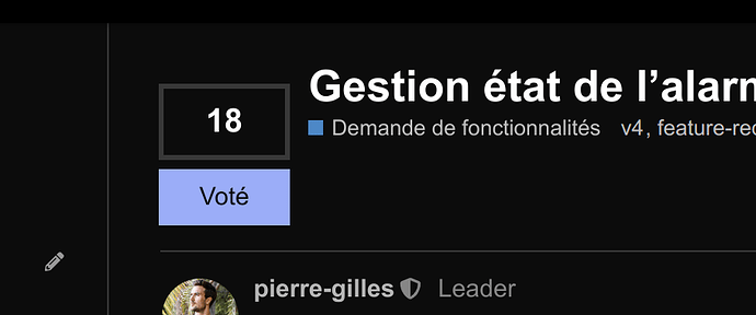

You mean 18 votes!! :wink:
19 votes woo which shows the topic is in demand :stuck_out_tongue:
