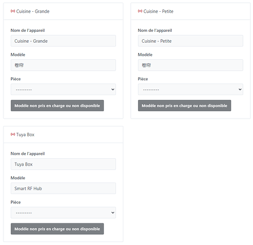

Hi @Lokkye,
I still see the shutters showing as unavailable. Should I delete them and recreate them in the Tuya box?
I’m not at home right now, I’ll test it when I get back.
Thanks!
I tested after removing and re-adding the blinds and they are still not recognized by Gladys.
Could it be because I need to go through a Tuya hub to control them?
Good evening @Mastho
Do you have any other Tuya devices?
Hi @Psoy,
No, I only have the shutters. I bought the box for the shutters.
Are those the switches that are connected, or actually the blinds, and is your connection Wi‑Fi or Zigbee?
@Mastho What exactly is the type of shutter and which box do you have? Do you have a « Tuya » account on the official Tuya app to control these shutters?
@Psoy: The switches communicate with the roller shutters at 433.92 MHz. The Tuya box can replace the switches by sending the 433.92 MHz signal to each shutter. The box is connected to my local network via Wi-Fi.
@pierre-gilles: I control my shutters via the Tuya app and the Volet roulant et battant aluminium ou PVC, électrique ou manuel, pose facile !. I do have a Tuya account where I can find my shutters and the box via the app. I followed the procedure that lets me connect my Tuya account to Gladys. I can see the box and each shutter appear as separate devices in Gladys, as you can see in the image below.
I think that, as can be seen in the image, this box is not yet supported by Gladys. In my case, I have Wi-Fi switches that control the roller shutters and over Wi-Fi it works with Gladys. You should check with @Lokkye so that he integrates this system, or maybe submit a feature request in the meantime. :wink
[quote="Mastho, post:13, topic
Yes, I confirm — if Gladys says it’s not supported then it’s not supported
I invite you to create a feature request with as much information as possible!
Hi,
Okay. I thought that @Lokkye’s change within the thread « Prise en compte des volets roulants par l'intégration Tuya » would be enough for Gladys to know how to manage the roller shutters and that going through a Tuya Box was an internal step within the Tuya ecosystem.
I’ll submit a feature request when I have a moment.
Thanks for your feedback!!
